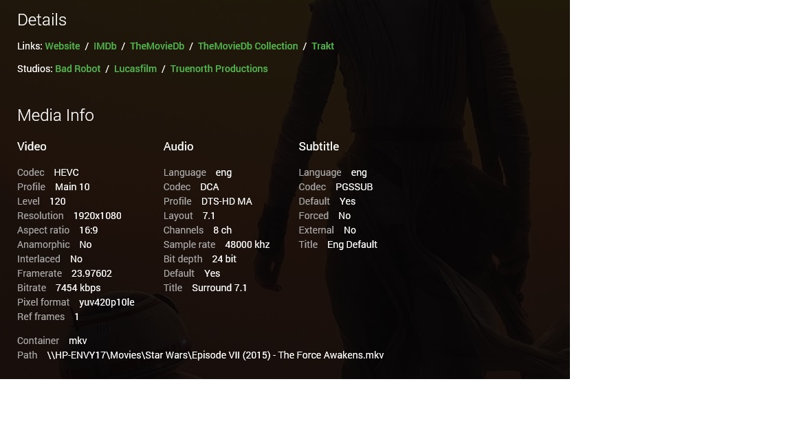

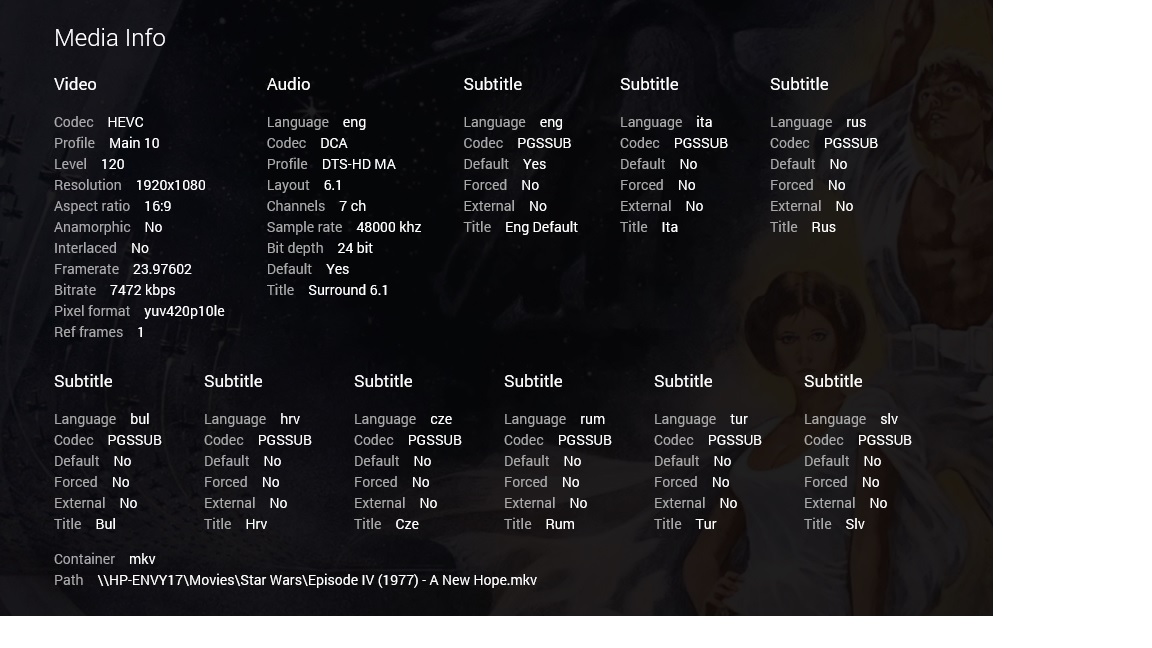

christian875 2 Posted August 2, 2016 Posted August 2, 2016 Just tried to play my Star Wars collection and half won't 1) load and gives me a "Player Encountered ..will re-try" problem and the other half 2) are transcoding whereas they were direct play before. I provided the movie file data below and logs (attached for file not loading) for your reference. Please help! Movie info that is not loading (log attached): Movie file that is transcoding (previously it was direct playing): log.txt

christian875 2 Posted August 3, 2016 Author Posted August 3, 2016 On the one that says it will retry, does it then work? On the second one, be sure subs aren't selected. ok so apparently it is the DTS sound. I checked the downmix stereo option and the files that were not loading now play but still transcoding. any ideas on how to get to direct play?
ebr 16337 Posted August 3, 2016 Posted August 3, 2016 It is not going to be able to direct play when the only sound track available is DTS-HD. It will have to transcode the audio. What is the device?
