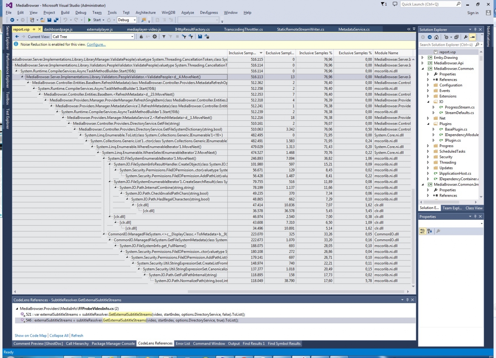

softworkz 5127 Posted August 6, 2016 Posted August 6, 2016 @Luke: Your recent changes looked good - I would have done the same. But unfotunately it didn't solve the problem. So I profiled the application to see what's going on:
Solution softworkz 5127 Posted August 6, 2016 Solution Posted August 6, 2016 I prepared a fix for it. After applying the people refresh task took 7min. Before it was 1h 20min. https://github.com/MediaBrowser/Emby/pull/2029 5
