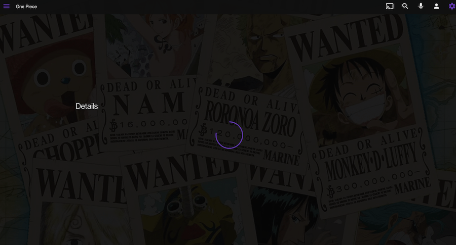

iBoss 31 Posted August 16, 2016 Posted August 16, 2016 Here it is. I have waited around 25 minutes If you go to the detail screen of a next up episode, then click the season link, are you able to see episodes for that season? No, it shows just an infinite loader indicator I'll update to the new version 3.1.106 and do the test again. thanks

iBoss 31 Posted August 16, 2016 Posted August 16, 2016 (edited) Version 3.1.107.0 Details TV Shows: No seasons list (I was waiting there around 20 min) If you go to the detail screen of a next up episode, then click the season link, are you able to see episodes for that season? Detail screen of a next up episode, then click the season link: yes I see the episodes for that season but after around 20 min. the cover image for that season is shown after around 11 min; and then the episodes list are shown after around 10 min Thanks server-63606937429.txt Edited August 16, 2016 by iBoss
