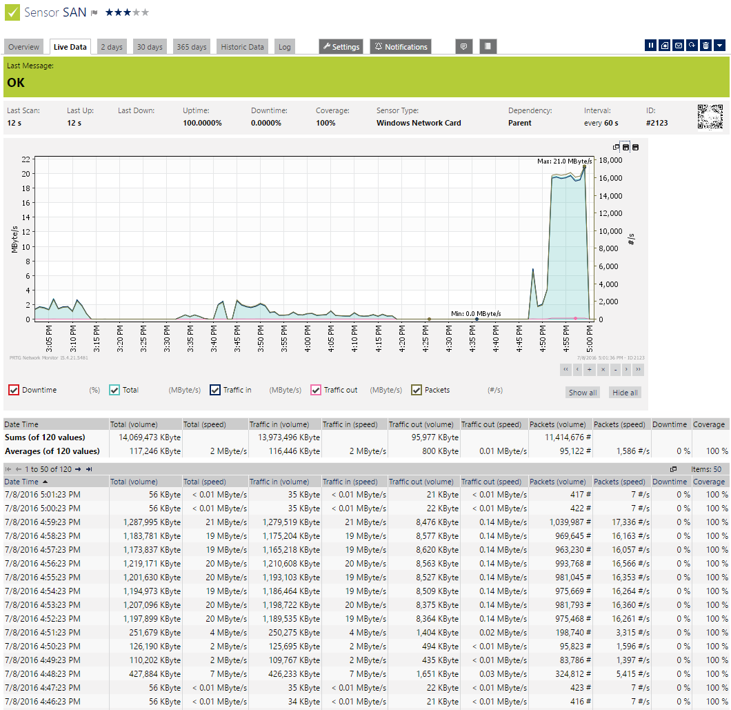

pir8radio 1313 Posted July 8, 2016 Posted July 8, 2016 (edited) I can confirm a similar result. I have transcode throttling enabled.... So when my users start a video it starts transcoding as hard as it can then dies down, until they catch up... then it transcodes at a slower pace to keep ahead of the player stream in chunks. The graph below shows a user watching a movie that started before 3:00. I did a quick test using the web GUI and started a movie that was encoded at 15.7Mbps and transcoded it to 5Mbps @ 4:48 on the graph.. It transcoded enough to build a buffer, then started to die down...(like it should) I switched the client to maximum bitrate so the movie would just remux @ 4:52, ffmpeg pulled the movie way harder and non stop until the whole movie was on my transcode drive. Just as you see in your setup. Looks like mine is still throttling more than yours though, topping out at 21MBps or 168Mbps.. Anyway, long story short pretty much does the same for me... Which as far as I understand, is normal. Edited July 8, 2016 by pir8radio
MSattler 390 Posted July 9, 2016 Author Posted July 9, 2016 I can confirm a similar result. I have transcode throttling enabled.... So when my users start a video it starts transcoding as hard as it can then dies down, until they catch up... then it transcodes at a slower pace to keep ahead of the player stream in chunks. The graph below shows a user watching a movie that started before 3:00. I did a quick test using the web GUI and started a movie that was encoded at 15.7Mbps and transcoded it to 5Mbps @ 4:48 on the graph.. It transcoded enough to build a buffer, then started to die down...(like it should) I switched the client to maximum bitrate so the movie would just remux @ 4:52, ffmpeg pulled the movie way harder and non stop until the whole movie was on my transcode drive. Just as you see in your setup. Looks like mine is still throttling more than yours though, topping out at 21MBps or 168Mbps.. Anyway, long story short pretty much does the same for me... Which as far as I understand, is normal. Ok that does make me feel better about what I am seeing. Although, this shows where Transcoding is not nearly as good as Direct Play. Using Kodi and Direct Play I would only see the throughput of the actual stream, maybe a bit less, maybe a bit more. I wonder if no remuxing were done if the bitrate was more along the line of Direct Play even with Direct Streaming. Luckily I have 4GB of throughput on the Emby Server. Need to switch this other unraid server over to a 2GB link. Thanks guys!
