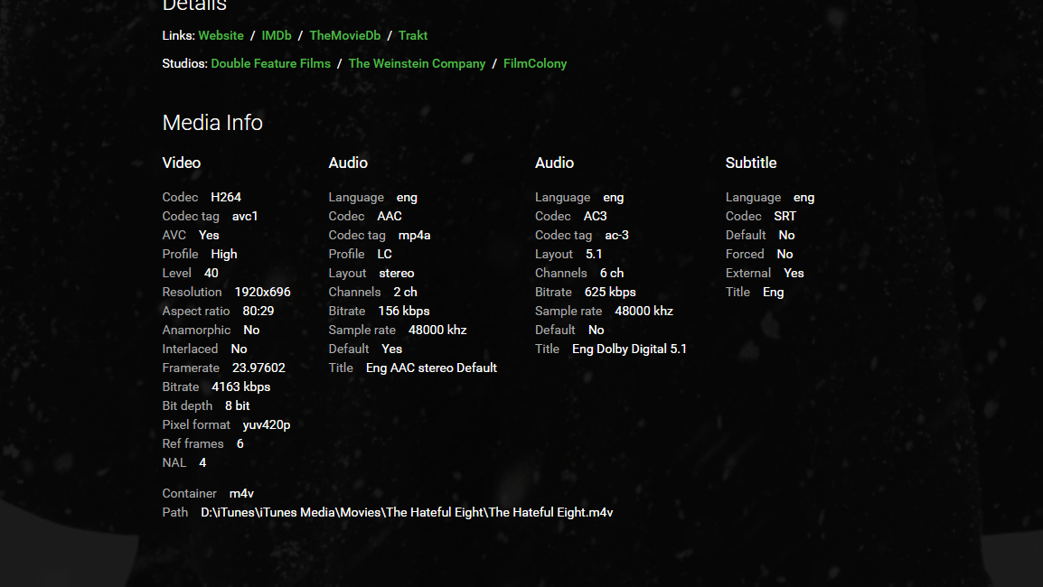

vast1983 0 Posted July 8, 2016 Author Posted July 8, 2016 This work for you? Really an example is now, any time I try to play back any movie file, it will play for anywhere from 10 seconds to 2 mins. Then it will kick me out to the title selection screen, as though a pressed back on the remote. Same with my android phone. Ive been handbraking my titles with the same preset for a couple years, so nothing has changed there. I did change server hardware, from an i3 NUC to an i5 NUC about 2 months ago, but that has been operating fine up until recently.
Luke 42243 Posted July 8, 2016 Posted July 8, 2016 The only thing that jumps out is 6 reference frames for h264 1080p is a little on the high side. That might be a little too much for the decoder to handle. Since you're using handbrake, can you do a test and encode a similar or the same video with 3 or 4 reference frames? 4 is generally considered the upper limit for 1080p. Thanks.

Luke 42243 Posted July 8, 2016 Posted July 8, 2016 Yea we probably need to be excluding this video from direct play and transcoding it, it's just a little complicated because the rules need to vary based on input resolution, and we have to add that ability to our decision making process. So for instance, at 1080p h264, the upper limit is generally 4. At 720p, it's a bit higher, etc. It's on our to do list so that it ultimately will just work.
vast1983 0 Posted July 8, 2016 Author Posted July 8, 2016 Anything above 4 reference frames seems to be the culprit. I think I've never noticed it before because I use a mix of emby (my preferred) and an Apple TV using homesharing (my wife's preferred, boo) I think we just got lucky with my wife choosing said movies with over 4 ref frames. Great catch! And thank you for making such an amazing media consumption ecosystem!
