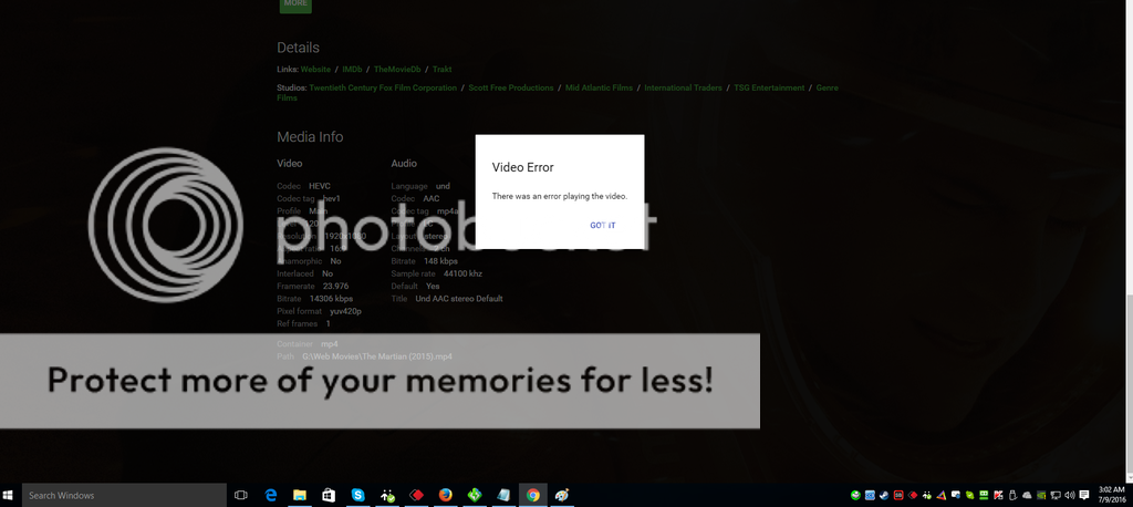

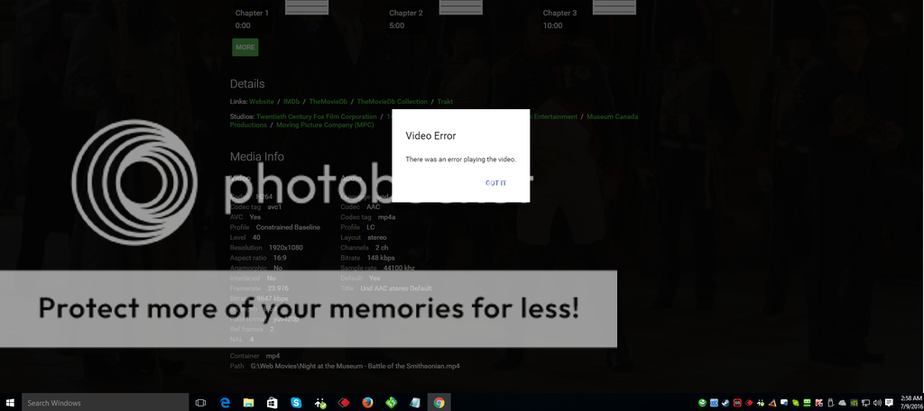

jayw654 5 Posted July 9, 2016 Author Posted July 9, 2016 Okay it seems even h.264 is affected as well. so here are some screenshots. Also the logs WILL require a login but this can be done through a web browser. URL: https://fileserver.jpwservices.net Username: emby Pass: 12345
