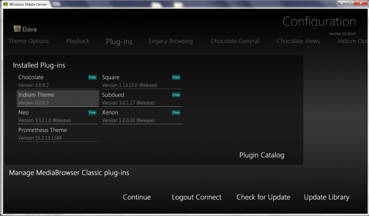

Cheesegeezer 3106 Posted March 25, 2015 Author Posted March 25, 2015 MBClassic-2432015fe005d64686945b68cf0036d4f3f7544.logMBClassic-2432015e0cb4895c7d64ab9928667842467e49b.log Here are some logs. I logged in under Neo, switched to Subdued. Exited and entered again and Chocolate was showing. Entered, switched theme, exited and entered with default theme showing. Ok so I have my setup nearly the same as yours and I can't for the life of me reproduce the boot up. However I haven't updated Prometheus on this laptop for a while. attached is a link yardameus to the same Prometheus I'm using. Backup your current version and drop this into your plugins folder and see if that fixes the issue. If it does, move this bug over to the Prometheus thread. https://www.dropbox.com/s/s0feoc7kgqbr4gt/Prometheus.dll?dl=0 This may help out @@BeppoMonkeyBoy somehow. Look at my screen shot to see my version number installed. 1
BeppoMonkeyBoy 98 Posted March 26, 2015 Posted March 26, 2015 Ok so I have my setup nearly the same as yours and I can't for the life of me reproduce the boot up. However I haven't updated Prometheus on this laptop for a while. attached is a link yardameus to the same Prometheus I'm using. Backup your current version and drop this into your plugins folder and see if that fixes the issue. If it does, move this bug over to the Prometheus thread. https://www.dropbox.com/s/s0feoc7kgqbr4gt/Prometheus.dll?dl=0 This may help out @@BeppoMonkeyBoy somehow. Look at my screen shot to see my version number installed. Screenshot 2015-03-25 19.55.45.png I can't replicate it either, but if you are getting the issues, a screen shot like Cheese's is a very helpful starting point to see if i can replicate. 1
yardameus 221 Posted March 26, 2015 Posted March 26, 2015 Ok, so I tried a few things out. Stuck the version I had back into Emby classic (15.3.23.2028), started it up, back into Chocolate again. Removed that version, tried Cheesegeezer's 15.2.19 I think. No issues, downloaded the latest, 15.3.26 from earlier today, no issues. Either way, subdued and xenon stay as the theme. Must've been something weird with my setup and/or that particular version. Anywho. All's good now, and we can release the hostage that I have made out of Subdued's help thread. 1
