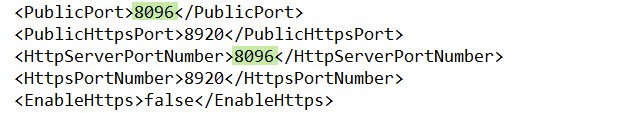

Abobader 3491 Posted June 25, 2016 Posted June 25, 2016 Good day, As Luke last reply, again change the 2 lines I highlight in the system.xml to be 8099, then save the file and restart the emby server: Let me know if that solve the issue. My best
Luke 42301 Posted June 25, 2016 Posted June 25, 2016 Good day, As Luke last reply, again change the 2 lines I highlight in the system.xml to be 8099, then save the file and restart the emby server: Let me know if that solve the issue. My best Thanks Abo. If he's just testing inside his local network right now, the public port doesn't matter yet. The public port = the router port, which only comes into play for external connections. 1
Abobader 3491 Posted June 25, 2016 Posted June 25, 2016 Forgot to add, when the emby server running, simply try localhost:8099 or yourpcip:8099 from the browser.
Abobader 3491 Posted June 25, 2016 Posted June 25, 2016 Thanks Abo. If he's just testing inside his local network right now, the public port doesn't matter yet. The public port = the router port, which only comes into play for external connections. Thanks Luke, yes true indeed.
