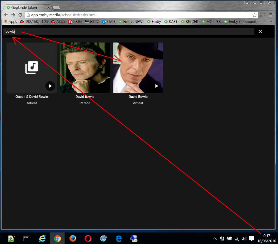

However, after a full scan, I noticed that my artist library contained the same pictures and artefacts.
I removed the library again, and I see that artists even show up in my search results (without having any artist for the moment)
Is there a way to delete/cleanup this database? I already runned every sheduled job, but no changes.

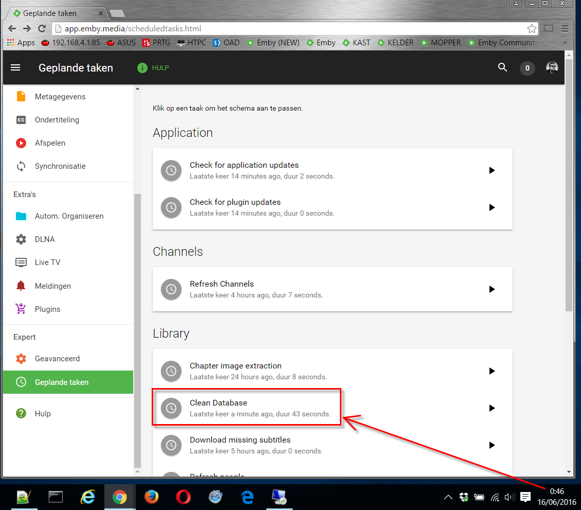

You ran the "Clean Database" task and it completed successfully?
plessers@gmail.com
@ebr: I'm afraid from yes:
