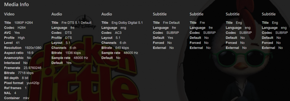

Crestj 68 Posted May 10, 2018 Posted May 10, 2018 Without making the original file available I'm not sure how I would do this. If I cut the first 10 minutes to make available it would involve re-encoding it and therefore (possibly) resolving the issue with the decoding, would it? Below is the media info which may mean something: It only happens on some videos but I've yet to determine the link. I assume the "Past duration 0.998985 too large" messages in the failing logs mean nothing?
