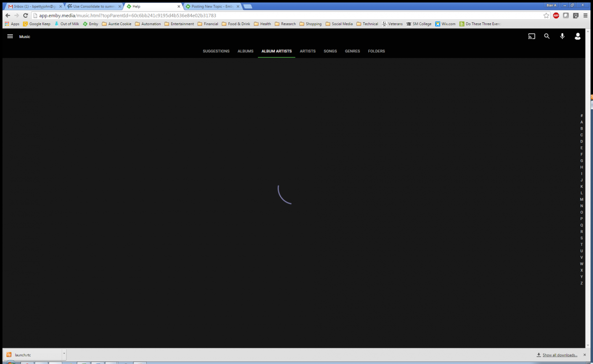

The movie/TV database processes quickly, but the music is horribly slow (due to size, I assume - see screen shot - the little wheel keeps on turnin'...).

Just checking in... I'm unable to display the Album Artists... the wheel just spins, most likely due to the size of the database.
Has anyone had this issue and if so, do you know of a way to correct it?
This is an issue with my HTPC's running Emby Theater on Windows 10 (x64).
This is an issue with the web GUI.
This is an issue with the Android app as well (Galaxy S6 / Galaxy Tab S2)...

The Issue:
    - When selecting "Album Artists", "Artists" or "Songs", the revolving circle just spins and never launches the page.
    - All of the movie/TV folders operate as expected.
    - Music "Suggestions" launches without issue.
    - Music "Albums" launches without issue and I can click through all pages to the end of the list.
    - I can play locally or stream, all movies/TV/music content without issue.
       - From all of the devices listed above.
Attached:
    - Emby Log while wheel was spinning (EmbyLog_06.10.2016_0804PST)
    - 2016-06-10 (1) (Home Page screenshot)
    - 2016-06-10 (2) (Music Suggestions page screenshot)
    - 2016-06-10 (3) (Music Albums page screenshot)
    - 2016-06-10 (4) (Spinning wheel on Album Artist page screenshot)
Hopefully I've included enough info to troubleshoot...
