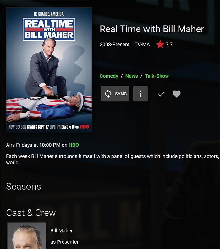

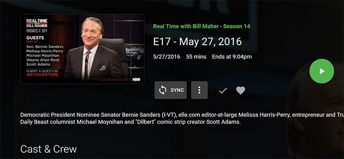

Zodler 18 Posted May 28, 2016 Author Posted May 28, 2016 On Version 3.0.5972.0 this problem still exists. As you can see from the screen captures. The episode is added and shows on the main page but it is not accessible from the show's page. 1

Zodler 18 Posted June 5, 2016 Author Posted June 5, 2016 Guys this problem as I posted an image still exists. You see Seasons but nothing below it. How can I correct it?
