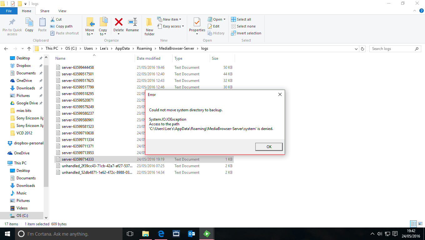

billy24752 0 Posted May 24, 2016 Author Posted May 24, 2016 i tried to delete the old emby server befoe installing the betea one. now get the atatched error messege. is this a problem?
Luke 42186 Posted May 24, 2016 Posted May 24, 2016 something is probably still running preventing that, which could possibly be the explorer window. having the folder open could prevent the uninstaller from working. if you still have an issue then just delete that mediabrowser-server folder and install the beta installer from the website. thanks.
