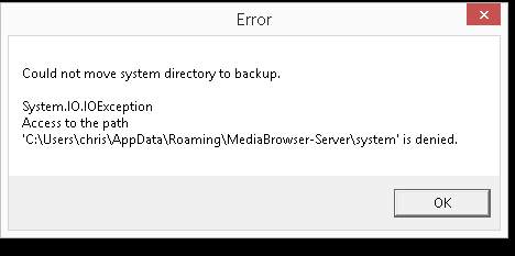

tmservo 2 Posted May 20, 2016 Posted May 20, 2016 Currently running Server 5885. I shut it down to upgrade to the new (5934) and it fails... generating this error. Log files: https://onedrive.live.com/redir?resid=D76DDC71AADC6470!383807&authkey=!ALFF--YQK-yWz4I&ithint=file%2ctxt
tmservo 2 Posted May 20, 2016 Author Posted May 20, 2016 Note: I also can't uninstall Mediabrowser from control panel; that fails.. so if that is suggested; I'm not sure what happened here..

jordy 284 Posted May 20, 2016 Posted May 20, 2016 (edited) @@tmservo, just a thought... can you write a new (txt or something like that) file to the users\chris\appdata\roaming\... folder. Maybe the write permissions have changed? Edited May 20, 2016 by jordy

jscoys 147 Posted May 20, 2016 Posted May 20, 2016 Yeah I have been having this for a while now. In fact if you go into task manager you'll see that the service has correctly shut down but the process "Emby server" is still running. You've got this message because the new install can't rename the directory "system" because it's in use by the process not terminated. What i do here is that i wait between 2 minutes and 5 minutes and in general the process terminates by himself. If not, i kill it... After the process terminated, you can smoothly do the new installation. Sent from my iPhone using Tapatalk

ebr 16307 Posted May 20, 2016 Posted May 20, 2016 @@Luke : we've got a workaround here but in the near future a look at this should be done. I confirm that it does this for fresh installs too. Sent from my iPhone using Tapatalk There isn't a lot we can do. The problem is that a program from within that folder is still running. We've asked it to terminate but, in some cases - and many beyond our control, a process could take a long time to actually quit.
jscoys 147 Posted May 20, 2016 Posted May 20, 2016 There isn't a lot we can do. The problem is that a program from within that folder is still running. We've asked it to terminate but, in some cases - and many beyond our control, a process could take a long time to actually quit. As I said before, it's not an obscure process that we haven't got any control on it, it's the "Emby server" itself which for some reasons doesn't close immediately and takes 5 minutes... So in a near future we have to look closer to what happens after asking the app to exit because today it seems to hang more time it really needs (Maybe some external sync requests). The other problem is that it seems when we ask the "Emby" service to stop, it stops whenever the process still alive or not. So we're happy saying "if the service is closed I assume that the process is closed too" but... no! That's why you've got this error message when you try to update immediately after. Today the workaround I proposed or Luke's solution are both valid to update to a new server version.
