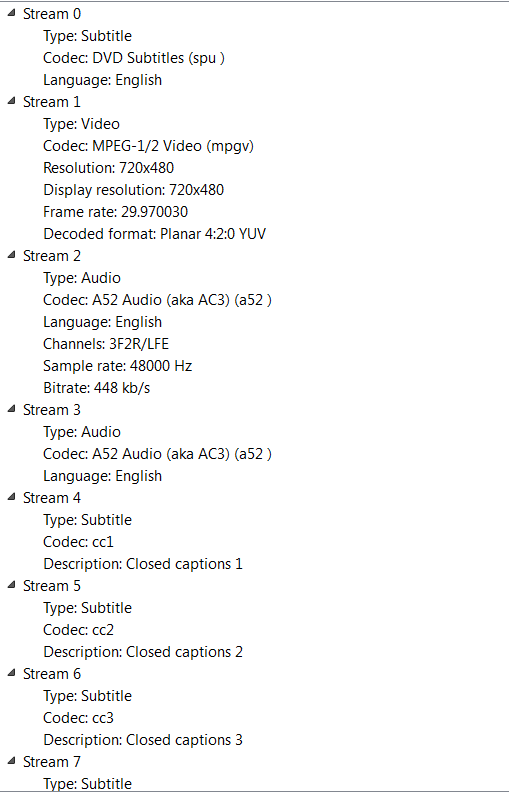

dukejames 3 Posted May 18, 2016 Author Posted May 18, 2016 That's what I find odd. I'm expecting 16:9 at 720p. It's a VOB file being trans-coded. Please see the screenshot of the Codec screen from VLC player attached. The video plays at greater quality through VLC. Other VOB titles seem to trans-code fine as well. Could Emby have identified the Media Info incorrectly, and then trans-code at lower quality?

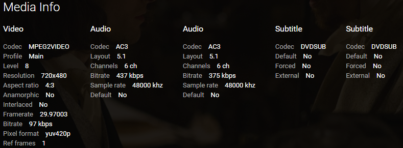

Luke 42241 Posted May 18, 2016 Posted May 18, 2016 Looks like the transcoding log explains it. The source is 720*480 (480p). When we transcode we're not specifying an output resolution, which typically results in ffmpeg ouptutting the same resolution as the input. However, looking at the log, it says it is outputting as Output #0, matroska, to '/var/lib/emby-server/transcoding-temp/bedf2c706fcd6c136a6292e1cc3777ce.mkv': Metadata: encoder : Lavf57.25.100 Stream #0:0: Video: h264 (libx264) (H264 / 0x34363248), yuv420p, 426x318 [SAR 212:213 DAR 4:3], q=-1--1, 100 kb/s, 29.97 fps, 1k tbn, 29.97 tbc I'm not sure why it's outputting at 426*318, possibly due to being anamorphic. Since this is a folder rip structure, keep in mind that we consider all transcoding of these to be experimental. They are not officially supported by ffmpeg, therefore we can't call them fully supported either.
Luke 42241 Posted May 18, 2016 Posted May 18, 2016 I'm sorry, this is my mistake. we are actually specifying a resolution - a max width of 426. let me look at why it might be doing that.
Luke 42241 Posted May 18, 2016 Posted May 18, 2016 Ok, I see why. the ffmpeg media probe detected a source bitrate of 97kbps, which is obviously wrong, but unfortunately that's just our reality as they don't support folder rips. So then what happens during transcoding is we look at that really low value and we try to be smart and limit the output resolution to something that is appropriate for 97kbps.
dukejames 3 Posted May 22, 2016 Author Posted May 22, 2016 Sorry for the late response. Can this be manually repaired and if so how?
Luke 42241 Posted May 22, 2016 Posted May 22, 2016 Unfortunately outside of modifying the database there is currently no way to do that.
