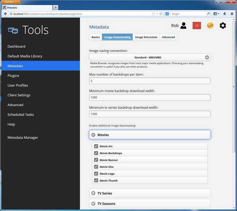

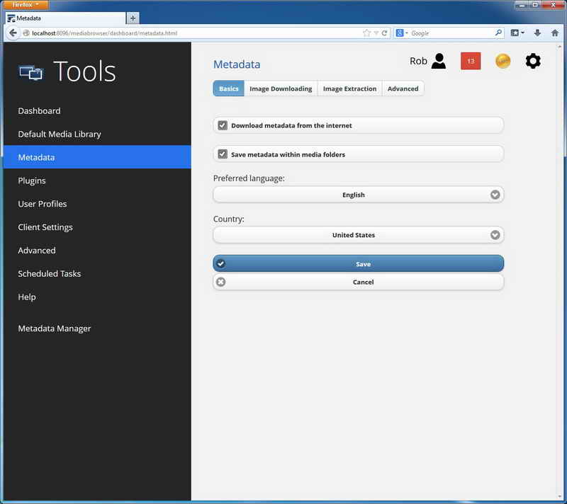

Luke 43479 Posted January 2, 2014 Posted January 2, 2014 can you post screenshots of all your metadata settings

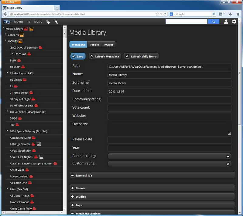

Luke 43479 Posted January 2, 2014 Posted January 2, 2014 Use the refresh button from the edit page for some of the titles. If there's still no change in metadata check the server log for errors
