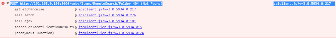

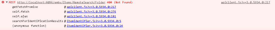

PHPpro 3 Posted May 11, 2016 Posted May 11, 2016 I am trying to manually identify a movie by name, but when I search It does not do anything. I pulled up the console and this is what I see I also tried searching from the server, but I get the same error I have checked the logs and I see entries like this 2016-05-10 20:22:20.0101 Info HttpServer: HTTP POST http://192.168.0.106:8096/emby/Items/RemoteSearch/Folder. UserAgent: Mozilla/5.0 (Windows NT 10.0; Win64; x64) AppleWebKit/537.36 (KHTML, like Gecko) Chrome/50.0.2661.94 Safari/537.36 2016-05-10 20:22:20.0101 Error NotFoundHttpHandler: [::ffff:192.168.0.106]:8096 Request not found: /emby/Items/RemoteSearch/Folder 2016-05-10 20:22:20.0101 Info HttpServer: HTTP Response 404 to 192.168.0.101. Time: 0ms. http://192.168.0.106:8096/emby/Items/RemoteSearch/Folder

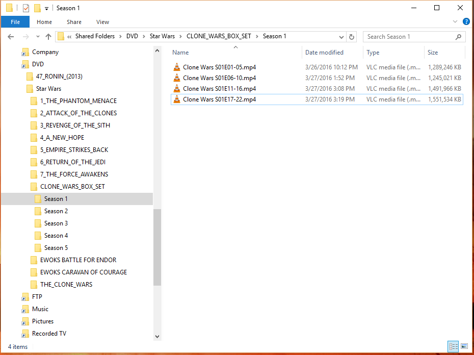

Luke 42186 Posted May 11, 2016 Posted May 11, 2016 Ok, the problem is that Emby Server has not detected the item as a movie, which means that the folder structure doesn't match the naming guidelines. Can you show us what the movie folder(s) look like? Because it's not recognized as a movie, the identify function should not even be there and i will be resolving that.
dcook 303 Posted May 11, 2016 Posted May 11, 2016 From what it looks like in the Metadata Manager none of your star wars movies are being recognized, you need to follow the naming convention, remove the digit and all the underscores. https://github.com/MediaBrowser/Wiki/wiki/Movie-naming Also not that it matter from EMBY but why are you in ALL CAPS its like you are yelling at yourself

Happy2Play 9800 Posted May 11, 2016 Posted May 11, 2016 (edited) The Clone Wars Box Set is a Series not a Movie, you can't identify a series that has be classified content type Movie. You have a "Mixed" content environment. Edited May 11, 2016 by Happy2Play

Happy2Play 9800 Posted May 12, 2016 Posted May 12, 2016 (edited) Then why didn't you set the library to Unset (Mixed content) instead of Movie? Content Type Edited May 12, 2016 by Happy2Play 2
