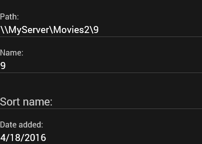

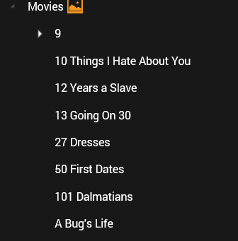

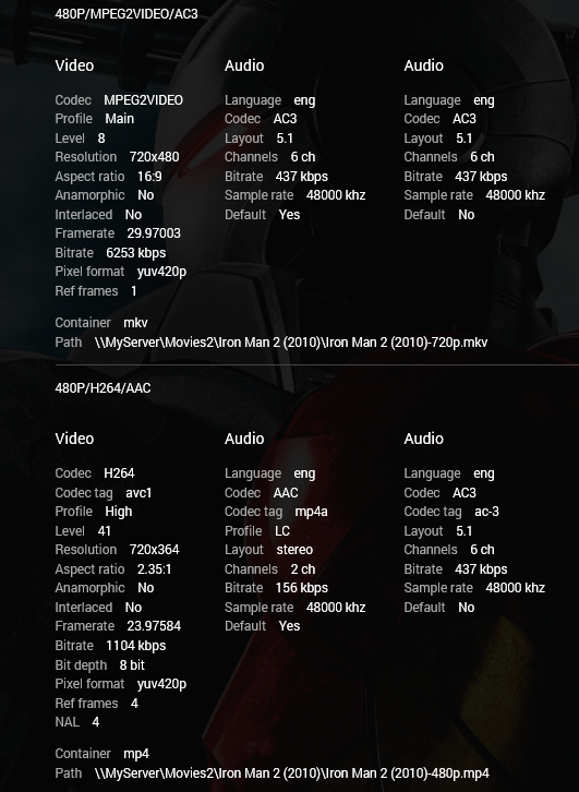

legallink 187 Posted May 9, 2016 Posted May 9, 2016 (edited) I'm getting duplicates (or removals) with multiple versions of the same file (but not all, only some - it is not consistent). I have followed the naming conventions indicated in the wiki and on the forums, although I am unclear as to whether the "-" needs a space before and after it or not, as I have tried both and I cannot get a consistent response. Additionally, for ones where it appears to have a "conflict" they don't show up in the movie list at all anymore, but they do show up in metadata manger (more like a folder). I've attached screen shots and am happy to provide relevant logs (though I'm not sure what the relevant logs for this one would be). The screen shots show: 1. The file naming convention utilized in the folder 2. The appearance of the item in the metadata manager 3. It not showing up in the library screen. 4. The file path showing up in Metadata manger indicating it more as a folder without recognizing the actual files. Thoughts? Additionally, is it possible to not rename the "base file" with the dash and simply rename the additional files with the dash? Edited May 9, 2016 by legallink
Luke 42186 Posted May 9, 2016 Posted May 9, 2016 that naming for 9 is correct. No, right now it's not possible to have a base file.

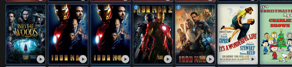

legallink 187 Posted May 9, 2016 Author Posted May 9, 2016 Any thoughts on why it is coming up incorrectly? For further documentation, I'm uploading some screenshots of iron man, which some work as linked and some don't. When they don't link here is what it looks like in the display (essentially as if the movie is there twice): The next pics are all going to be from Iron Man 1 and Iron Man 2. You'll note it processed Iron Man 2 just fine, linked the files, but Iron Man 1, I'm getting duplicates. The first pics are from Iron Man 1 (metadata manager, and the duplicate movie posters in the movie view, and the folder view). These pics are Iron Man 2 (note the file naming structure, etc. are the exact same.) I hope that is helpful.
Luke 42186 Posted May 9, 2016 Posted May 9, 2016 iron man seems to be missing the spaces around the dash

dcook 303 Posted May 10, 2016 Posted May 10, 2016 (edited) This is what the naming convention is for. Exactly that is my point, you are mixing MP4 and MPEG types, in the naming convention it says: /Movies/300 /300 - 1080p.mkv /300 - 720p.mkv What you have: Foldername: Iron Man(2008) Ironman (2008)-480p.mp4 Ironman (2008)-720p.mpeg Since one is a .mp4 and the other a .mpeg I suspect EMBY is seeing them as two different files. Also your folder name is not the same as the file name, which it should be as detailed in the naming convention. You can either fix the folder name and file name to match, or delete the low res version, so there is just one Edited May 10, 2016 by dcook

dcook 303 Posted May 10, 2016 Posted May 10, 2016 Legalink, check your folder/files again, you have a space in "Iron Man" in your files, but the folder does not have a space.
Luke 42186 Posted May 10, 2016 Posted May 10, 2016 yes it's foldername - 1080p.mkv foldername - 720p.mp4
legallink 187 Posted May 10, 2016 Author Posted May 10, 2016 Legalink, check your folder/files again, you have a space in "Iron Man" in your files, but the folder does not have a space. Perhaps that is related? I didn't think about files and folders having to be the same. Thanks for the thought! @@Luke, is that accurate?
dcook 303 Posted May 10, 2016 Posted May 10, 2016 Perhaps that is related? I didn't think about files and folders having to be the same. Thanks for the thought! @@Luke, is that accurate? From the Wiki: Each version must begin with the folder name, followed by " - ". If this requirement is not met, they will be treated as separate videos.
