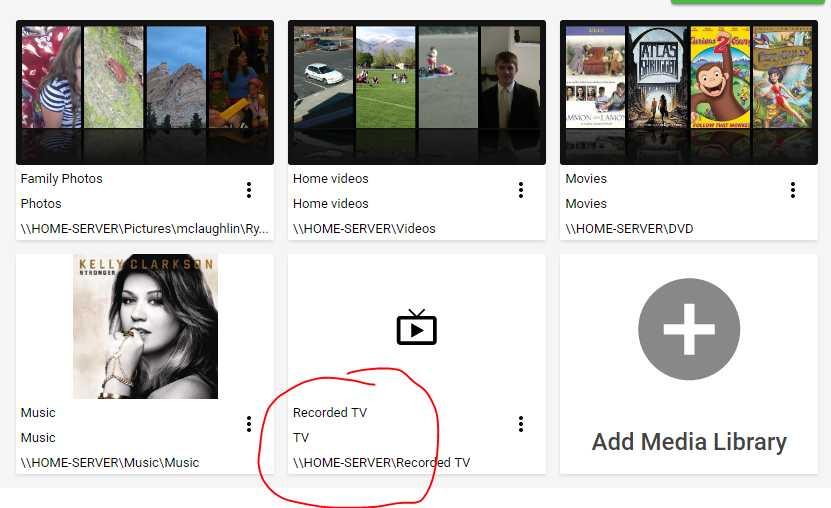

PHPpro 3 Posted May 8, 2016 Posted May 8, 2016 Just the other day my recorded TV stopped showing up in emby. When I look in the logs I see this error 2016-05-07 18:31:55.5735 Error LibraryMonitor: Error watching path: \\HOME-SERVER\Recorded TV *** Error Report *** Version: 3.0.5934.0 Command line: C:\Users\htpc.MCLAUGHLIN.000\AppData\Roaming\Emby-Server\System\MediaBrowser.ServerApplication.exe Operating system: Microsoft Windows NT 6.1.7601 Service Pack 1 Processor count: 2 64-Bit OS: False 64-Bit Process: False Program data path: C:\Users\htpc.MCLAUGHLIN.000\AppData\Roaming\Emby-Server Application Path: C:\Users\htpc.MCLAUGHLIN.000\AppData\Roaming\Emby-Server\System\MediaBrowser.ServerApplication.exe The directory name \\HOME-SERVER\Recorded TV is invalid. System.ArgumentException at System.IO.FileSystemWatcher..ctor(String path, String filter) at MediaBrowser.Server.Implementations.IO.LibraryMonitor.<>c__DisplayClass12.<StartWatchingPath>b__11() It says that \\HOME-SERVER\Recorded TV is not valid, however if I type that into Windows explorer it works fine. This was also working in emby up until recently. I wonder if one of the recent updates broke something.
PHPpro 3 Posted May 8, 2016 Author Posted May 8, 2016 I thought it might be a problem with the directory name having a space in it. So I created another directory called \\HOME-SERVER\RecordedTV and put a couple shows in it and rescanned the library. When it was done, I still didn't have anything listed under the Recorded TV library and I saw these two entries in the log. 2016-05-07 23:38:09.0843 Info LibraryMonitor: Watching directory \\HOME-SERVER\RecordedTV 2016-05-07 23:38:09.1503 Info LibraryMonitor: Watching directory \\HOME-SERVER\Recorded TV

Luke 42186 Posted May 8, 2016 Posted May 8, 2016 Hi, I don't think the space is a problem. Is that folder on the same machine? If not, perhaps the network or machine wasn't up when the server tried to reach it?

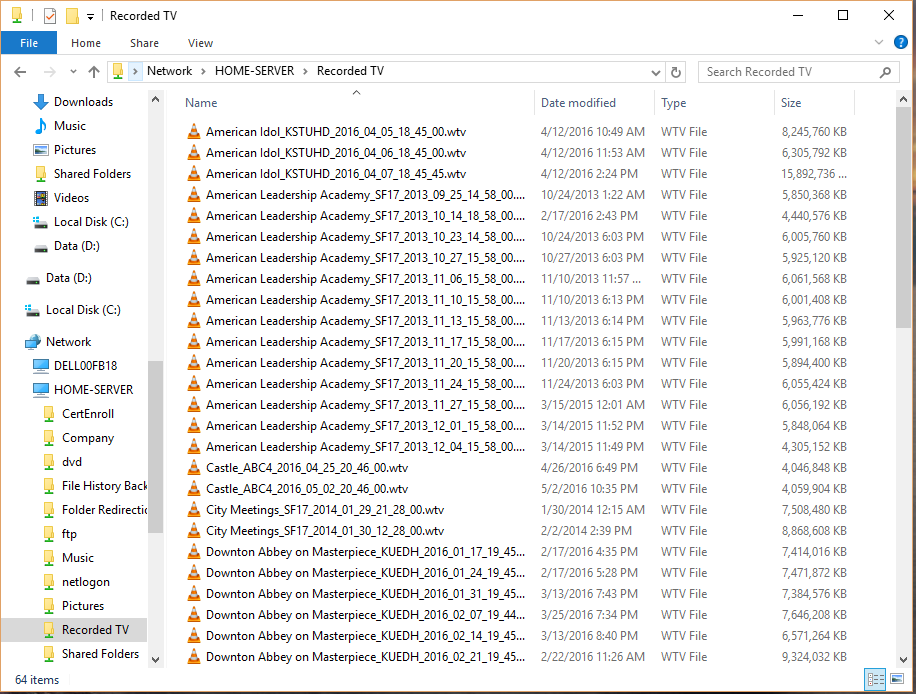

PHPpro 3 Posted May 9, 2016 Author Posted May 9, 2016 (edited) The folder is completely flat Edited May 9, 2016 by PHPpro

Luke 42186 Posted May 9, 2016 Posted May 9, 2016 Ok, right now, the tv content type is somewhat strict and requires following the structure listed in the tv naming guide: https://github.com/MediaBrowser/Wiki/wiki/TV%20naming We can look at handling that kind of flat structure for a future release. For now you might just want to reclassify it as home videos.
