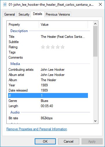

ebr 16307 Posted May 4, 2016 Posted May 4, 2016 What is the state of the tags inside of the songs? We rely heavily on the tagging over any sort of file structure.
RedBaron164 18 Posted May 4, 2016 Author Posted May 4, 2016 Tagging is almost perfect, I'd say about 85-90% complete. I use mediamonkey to tag all my songs. I just went through some artists that aren't showing up properly and the tags all look good.

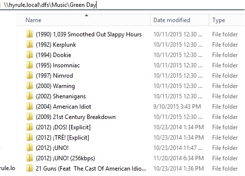

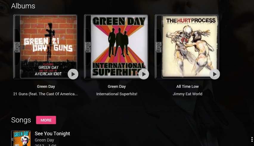

Tanamur 53 Posted May 9, 2016 Posted May 9, 2016 Hi Forum - I am at the point of concluding my overall database is "gummed up" beyond repair the way things are working. Here is what has brought me to that conclusion: Joe Jackson (4 Albums) FLAC - All fully tagged with MediaMonkey and tags visible with Explorer at the file Details level. \\NUC\ARCHIVE_Music\CDLR_FLAC\Joe Jackson \\NUC\ARCHIVE_Music\CDLR_FLAC\Joe Jackson\Greatest Hits \\NUC\ARCHIVE_Music\CDLR_FLAC\Joe Jackson\Look Sharp! \\NUC\ARCHIVE_Music\CDLR_FLAC\Joe Jackson\Night And Day \\NUC\ARCHIVE_Music\CDLR_FLAC\Joe Jackson\Steppin' Out-The A&M Years 1979-89 1) Emby Rescan and Full Refresh at the artist level results in no metadata. 2) Manually enter the artist MusicBrainzID: 07f6d469-38f3-46da-9cfa-2f532422b84e 3) Emby Rescan (no results) and Full Refresh at the artist level DOES populate the correct metadata. 4) Rescan all of database, Full Refresh of Music Library at MetadataManager and nothing is inherited or populated into the 4 albums. 5) Manually enter MusicBrainz Group ReleaseID and AlbumID, Full Refresh and no metadata populates to the albums. Out of 50 artists and approximately 100 albums, metadata has populated about 50%. I realize this may be drastic but after the problems I had 4-6 weeks back after "renaming" the TV library in the Dashboard/Library Manager, I sense starting over is the way to go. How do I go about deleting the entire database and starting over? I looked through the Windows Server Wiki Tutorials but did not see instructions there. Thx.
