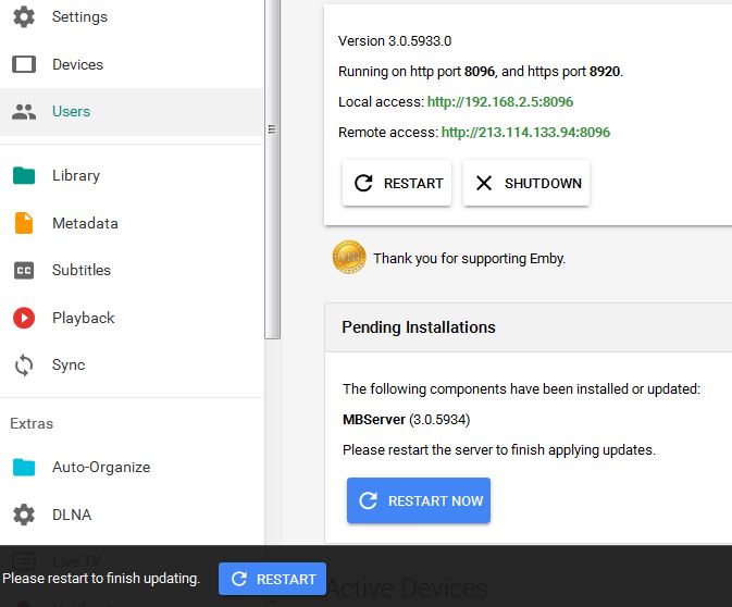

Betelgeuse 14 Posted May 2, 2016 Posted May 2, 2016 It say installation is complete, and needs to restart. After restart there is still 3.0.5933 installed and the message I need to restart. I have even restarted the computer. I had similar issue when updating to 3.0.5933, but after several restarts I suddenly had it installed. What is causing this?
Dibbes 515 Posted May 2, 2016 Posted May 2, 2016 (edited) So once in a while I'm having this same issue. It's usually a file that still locked for some reason. The workaround: - Exit the Emby server (or stop the service) - browse to C:\users\<your username>\AppData\Roaming\Emby-Server\ - rename the system folder to system.old - browse to http://emby.media/download.html - download and install from there Edited May 2, 2016 by Dibbes
Luke 42242 Posted May 2, 2016 Posted May 2, 2016 It say installation is complete, and needs to restart. After restart there is still 3.0.5933 installed and the message I need to restart. I have even restarted the computer. I had similar issue when updating to 3.0.5933, but after several restarts I suddenly had it installed. What is causing this? Hi, try installing from the website. Thanks.
Betelgeuse 14 Posted May 2, 2016 Author Posted May 2, 2016 (edited) Hope that will not overwrite all my settings? No, it did not! Worked like a charm! Thanks a lot! :) Edited May 2, 2016 by Betelgeuse
