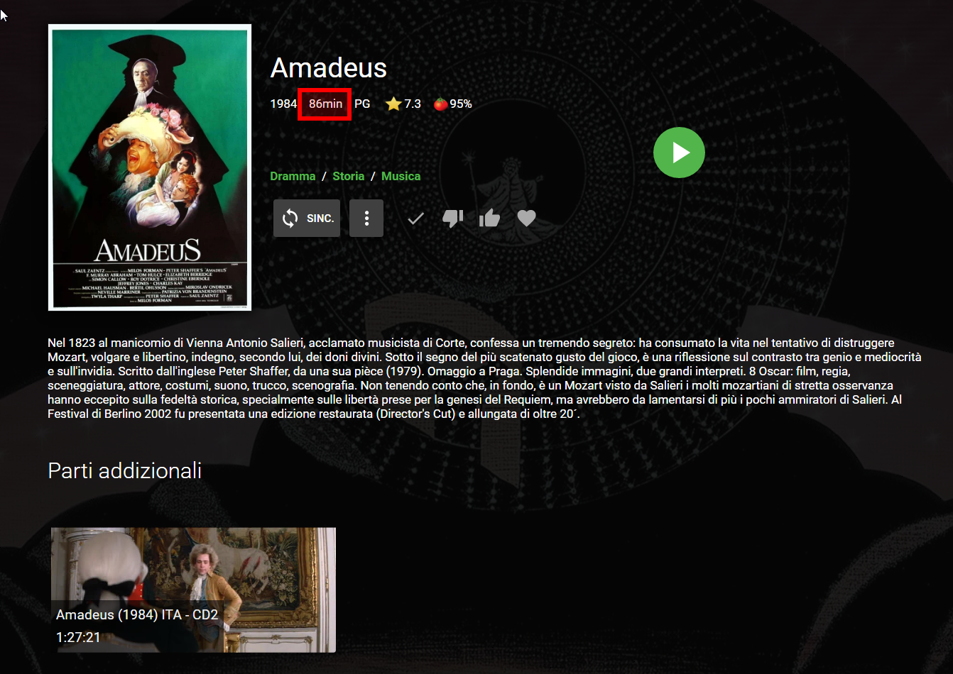

glengrant 8 Posted April 26, 2016 Posted April 26, 2016 Hi, i started to use emby recently This evening I noticed that with splitted movies (usually ending with CD1, CD2), the server seems to recognize apparently the additional part but it didn't load the data of the second part. Example Movie is Amadeus (1984) ITA - CD1.avi (lenght => 86min) Amadeus (1984) ITA - CD2.avi (lenght => 88min) and the server loads only the lenght and infos only from the first part. The problem afflict also emby for kodi because the server is unable to comunicate to kodi the existence of the second part. Below you find 2 screenshots please let me know if this is not working only for me .. server v 3.0.5931.0 win 7-x64 thanx-glen
Luke 42186 Posted April 27, 2016 Posted April 27, 2016 Hi, yes, we currently have some work to do still with stacked videos.

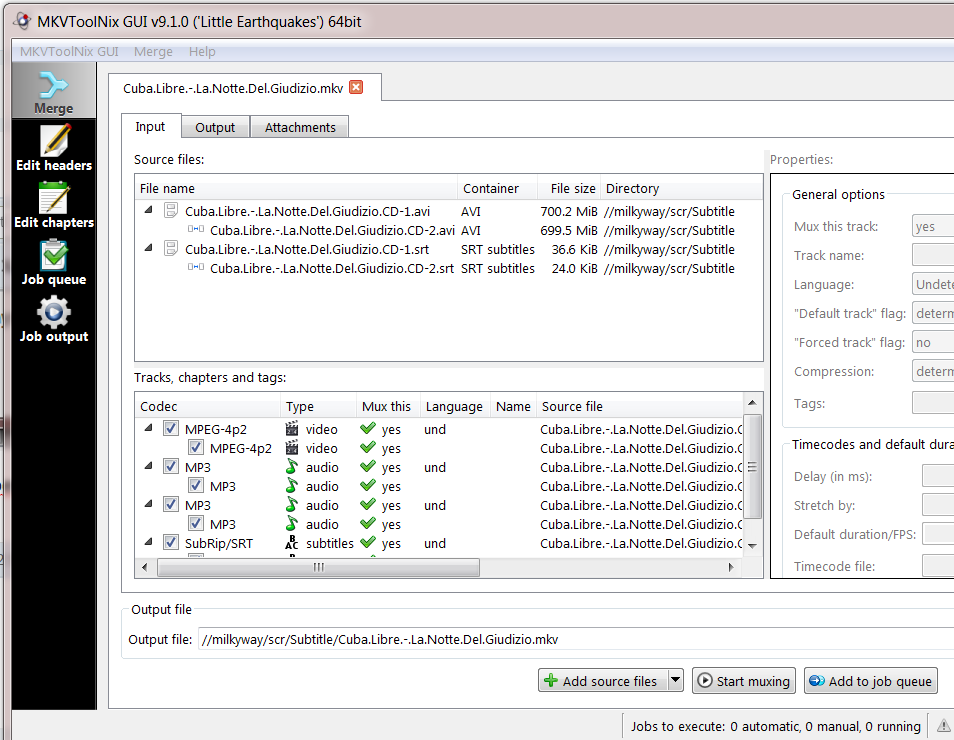

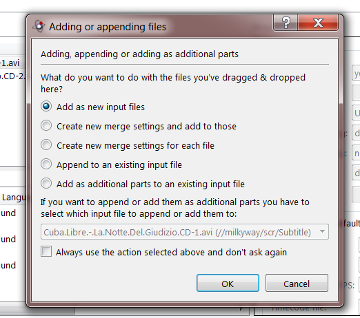

glengrant 8 Posted April 27, 2016 Author Posted April 27, 2016 ok, thanks it was important understanding that it was not me maybe a guide is not necessary but i'll post it anyway if someone is lookin for help in merging video files the tool is mkvtoolinix and it supports a lot of video/audio/subtiles formats at the end of the process, you'll have a single mkv file (as known, an mkv is a simple media container) https://mkvtoolnix.download Drag and drop 1st part of the movie on it, select the file, right click mouse, Append Files and append the 2nd part of the movie You'll have something like this : If you wanna you can put also subtitles, drag and drop the first part and click ok Now you can append the second part of the subtitles (right click on the subtitle file / append files) Choose your output destination and file name Click on Start Muxing and you'll have a mkv with cds and subs merged (there's no conversion, the process is very very quick - less than 1' for me to a computer in lan)
