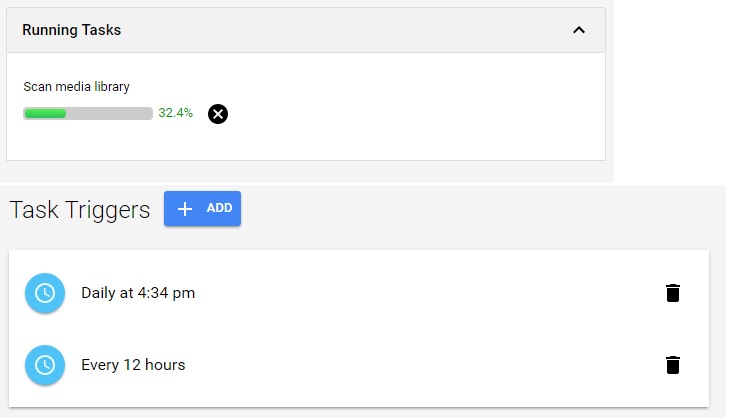

Happy2Play 9814 Posted May 13, 2016 Posted May 13, 2016 (edited) That would all depend on what/when you changed the default triggers to. Just tested Library scan. Edited May 13, 2016 by Happy2Play
dcook 303 Posted May 14, 2016 Posted May 14, 2016 Just to test you could set a scheduled task to run scan media library every hour.
Luke 42288 Posted May 14, 2016 Posted May 14, 2016 well i think the interval triggers are probably fine, it's the triggers for specific times that are not, and it's probably related to the server coming out of standby.
