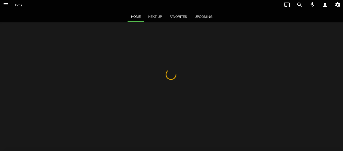

revengineer 142 Posted April 18, 2016 Author Posted April 18, 2016 Can you define would not load? Can you describe that a little? thanks.None of the emby ui shows in browser. Browser does not time out, spins wheel indicating that it keeps trying to load. After disabling coverage, emby server is still responsive this morning. Maybe the recent coverlet update introduced the issue. Will keep monitoring and report back if anything changes.
