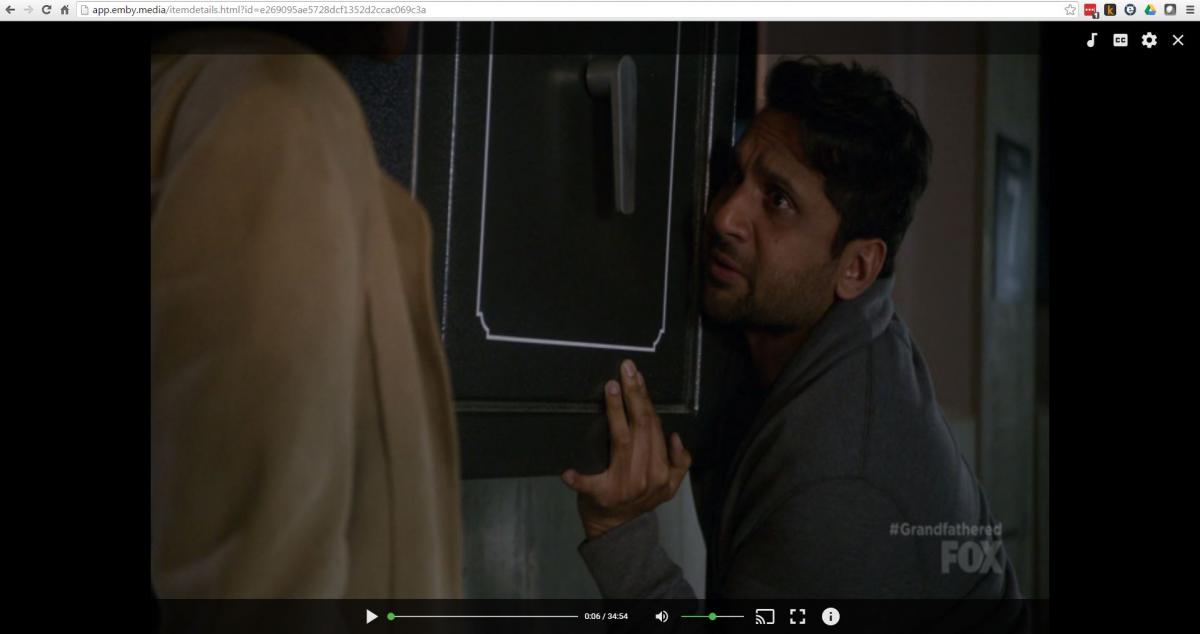

perx 4 Posted April 15, 2016 Posted April 15, 2016 I'm using WMC and Emby with a variety of clients - Chrome, Chromecast, Android TV, Android Phone. Live TV looks great, but the Recorded TV default aspect ratio is 4:3 instead of 16:9. I attached the transcode log and a screenshot, not sure if that helps. Is there a setting I might have wrong, any ideas are appreciated. transcode-552271a2-6829-47fb-8167-d91ea6f183a2.txt
Luke 42186 Posted April 15, 2016 Posted April 15, 2016 hi, as a test, try turning off quicksync and see if that makes a difference in your next recording. thanks.

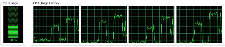

perx 4 Posted April 15, 2016 Author Posted April 15, 2016 (edited) I ran the test and that addresses the issue. With quicksync on the aspect ratio is 4:3 by default, with it off its 16:9. Do you think this is something that would be able to be fixed? Quicksync makes a pretty good difference on the cpu, see attached screenshot, with quicksync cpu is approx 50% vs 75% with it off. Edited April 15, 2016 by perx
