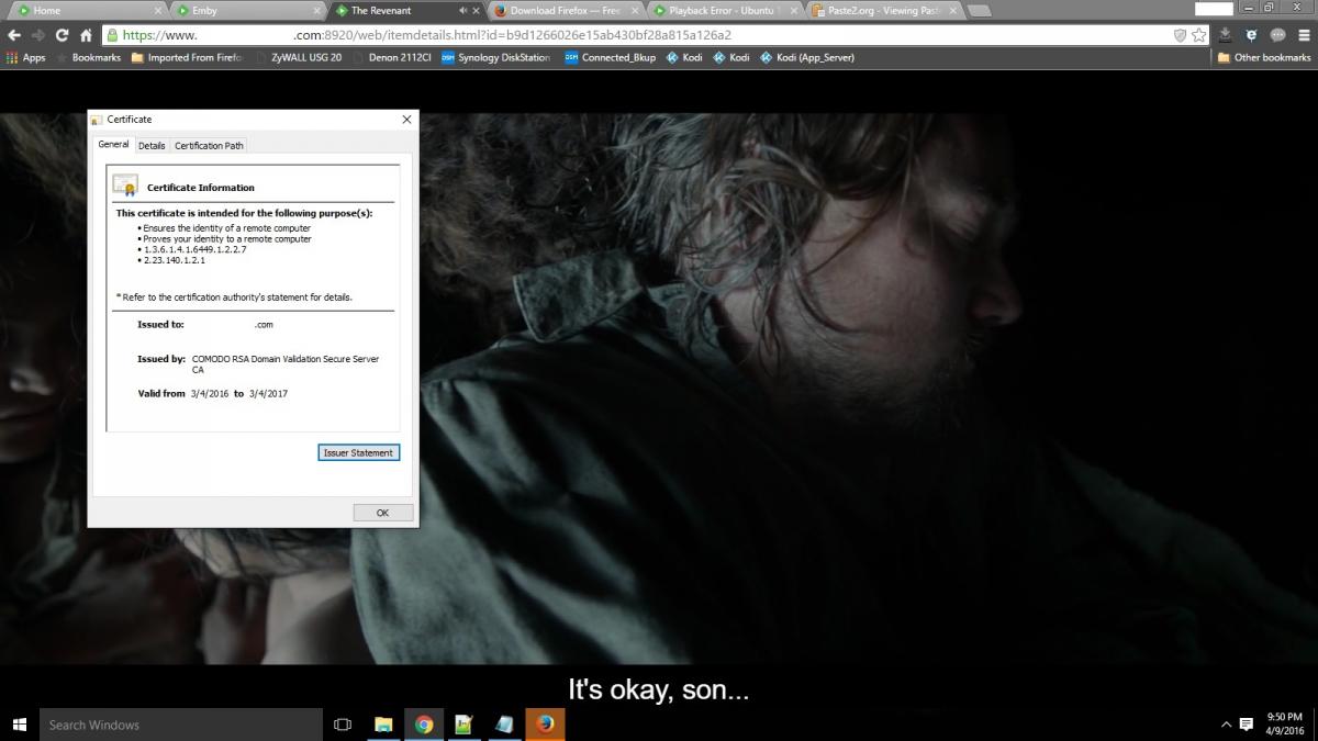

kcprophecy 3 Posted April 10, 2016 Author Posted April 10, 2016 Hey Luke, I imported the certificate but still no luck, Android see's it as a client certificate since it doesn't contain the CA attribute because it's not a self signed certificate. Here's a log from the Emby application on my phone, it isn't from the times from my original testing, but after I had tried importing the certificate and doing random tests. I tried removing the www from my dynamic DNS to have it match up exactly with the cn in the certificate, but no dice still. https://paste2.org/DnUfGZMO - Android Application Log Here's a screen shot of it also working on my computer after setting it back to www using Chrome connected over 8920. On this same computer though I get playback error if I use chrome to connect to my reverse proxy for Emby. Playback on firefox on the computer works through both my reverse proxy and port 8920. Sorry if it seems I am throwing a lot of different stuff at you guys but just trying to provide as many pieces as I can in hopes of fixing it. My main thing is just getting a working Emby Android application. I'd really like to keep SSL enabled for the application if possible so any assistance you guys can provide would be much appreciated.
