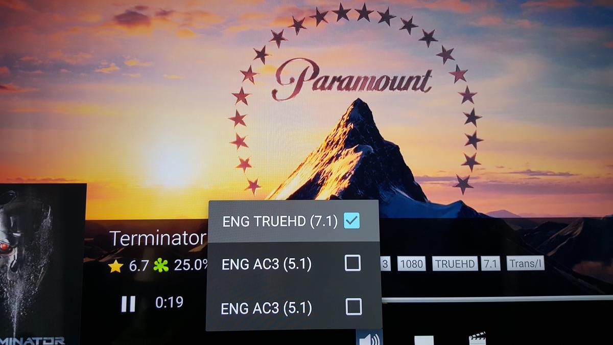

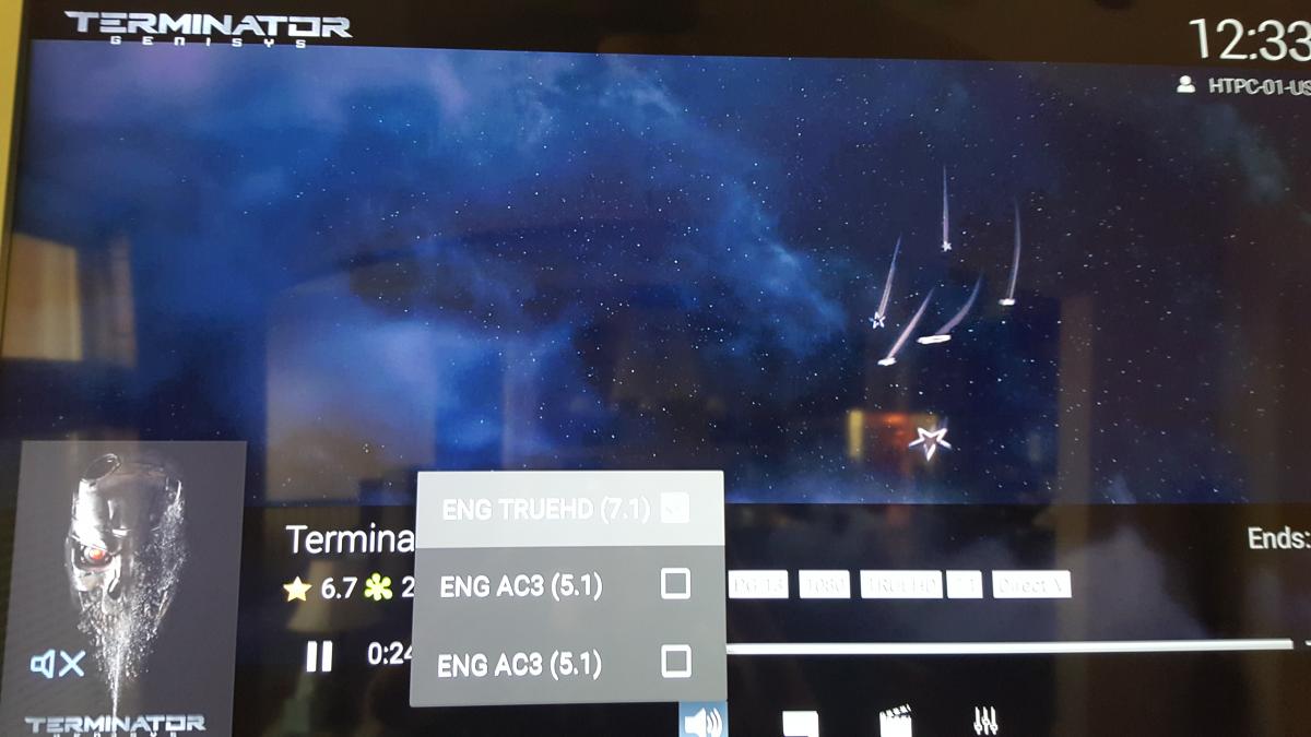

cbauer25 5 Posted April 10, 2016 Author Posted April 10, 2016 Here is the info you requested. Picture one is when I start the movie...you can see it is 7.1 TrueHD and it is transcoding. I pull up the audio options and switch it to 5.1. Picture two is after I select 5.1. You can see that it still shows 7.1 TrueHd and the menu still shows 7.1 selected...however it also states it is now Direct. Thanks. MediaInfo.txt server-63595843200.txt transcode-4f5512a4-7c51-4fd7-abf1-84e69f57c742.txt transcode-a9141e55-bae1-4832-a46f-8c237ef6a0d1.txt
ebr 16336 Posted April 11, 2016 Posted April 11, 2016 The OSD "gray boxes" will always show the default audio track for the item - it doesn't currently show the track that is actually playing (might be a nice enhancement though). In both situations, you actually are getting 5.1, correct? I think it is probably working correctly and it is only the menu that is not properly marking the selected track.

ebr 16336 Posted April 11, 2016 Posted April 11, 2016 I'm finding that it is very inconsistent. I just tried it 10 times and it only seemed to switch once. How are you determining if it "switched"? With the 7.1 track it will transcode and you will get 5.1 PCM. With the 5.1 track, it will direct stream and you will get 5.1 PCM. So, unless the two audio tracks actually contain different audio (like a commentary) you are going to be getting the same audio both times. The only issue is that, for some reason, it isn't able to properly determine the track to mark in the menu and, I believe, that is already fixed in the current beta.

cbauer25 5 Posted April 12, 2016 Author Posted April 12, 2016 How are you determining if it "switched"? With the 7.1 track it will transcode and you will get 5.1 PCM. With the 5.1 track, it will direct stream and you will get 5.1 PCM. So, unless the two audio tracks actually contain different audio (like a commentary) you are going to be getting the same audio both times. The only issue is that, for some reason, it isn't able to properly determine the track to mark in the menu and, I believe, that is already fixed in the current beta. Good question. How I was looking at it was checking what was marked in the menu (which we've determined is now fixed) and assuming that if the track was switched I would no longer have the stuttering video/freezing issues. If it is switching the audio, I still get the video issues. I think fixing the menu is a good step. I'll spend some time looking at server performance. Thanks for your help and your continued commitment!
