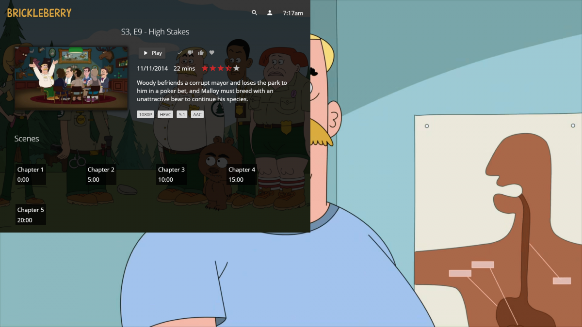

NWGiles 10 Posted March 17, 2016 Posted March 17, 2016 Hello I upgraded my htpc in the lounge from win 7 to win 10, HTPC is connected to the tv via HDMI over CAT7. Since upgrading to Windows 10, when I turn the TV off, and then back on again, EMBY theater resizes smaller, but only the front layer. I have attached pictures to show what happens when I play content without resizing. Once the tv is back on the front layer ( with the play pause options ) stays small but the back layer where the video plays resizes back to full screen as I would expect. I have read the other raised issue around this and I have the appropriate wndows 10 drivers, I have tried this with other VLC , WMP and even the EMBY windows app, everything else resizes full screen just not theatre. I prefer theater but its a problem (especially with the kids) getitng a keyboard out constantly to resize. Picture 1.png - when tv is turned back on this is what I see, if I press the full screen button (middle button top left) it goes back to the normal window and you get the blue windows background around it Picture 2.png - shows what happens if I play content like this ( video full screens but no the front layer) Picture 3.png - when I press stop this is what happens so the menu loads as normal but the 2nd layer with the video stays where it is behind. Please can this be fixed thank you

NWGiles 10 Posted March 17, 2016 Author Posted March 17, 2016 I have a similar issue, when I turn my TV back on ET is smaller, like in your screenshot, but doesn't have the empty black space around it, I can see my desktop underneath it. I've also noticed Rainmeter does the same thing, and I have to refresh my Rainmeter skin to get it to fill my desktop, so I don't believe it's strictly an ET issue. Even my Windows screen saver will only take up roughly 1/3 of my desktop every once in a while when I turn my TV on. its good that its more than me, I can only replicate it with emby theater though.
Deathsquirrel 745 Posted March 17, 2016 Posted March 17, 2016 I have the same issue in ET on Win10. You can maximize it once to go to full-scree windowed and twice to go full screen. If you have any tests you want run Luke I'll be happy to help.

NWGiles 10 Posted March 18, 2016 Author Posted March 18, 2016 (edited) I have 1 tv connected to htpc.I leave Emby theatre running I turn the tv off with remote.The tv is a 4K lg tv, running in 1900 x 1080 as it always has.Same tvSame htpcSame Emby theatreOnly difference is the upgrade to Windows 10. It never did this on Windows 7, I upgraded a week ago.The resolution of the tv is the same, my graphics card is win 10 compatible.The Emby Windows app doesn't do it, neither does anything else I have tried. Even the web version of theatre tv.Emby.media works perfectly, just not theatre.This is what is confusing me Edited March 20, 2016 by NWGiles
