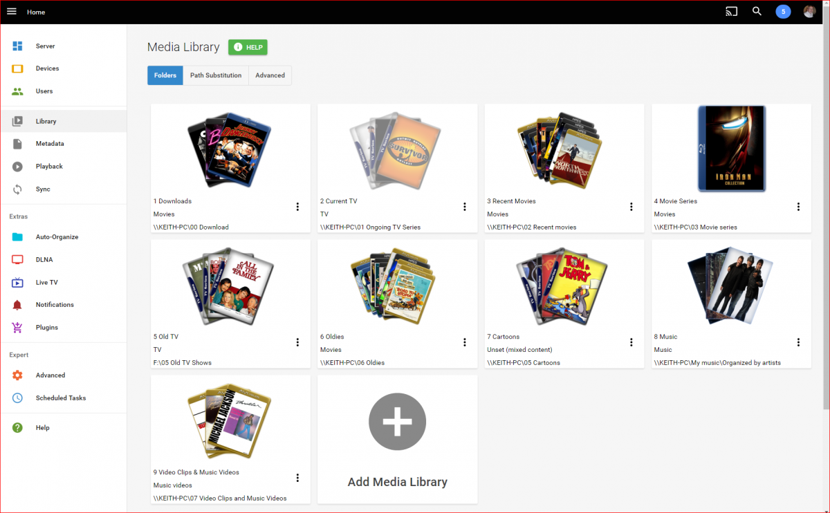

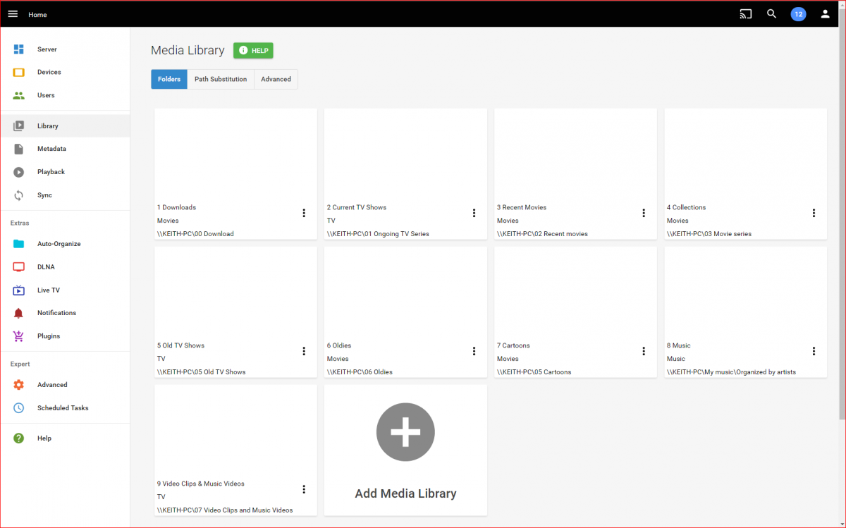

khodges747 55 Posted March 16, 2016 Author Posted March 16, 2016 There's still one problem... I can't access the library from the web interface on server 2. On server 1 it works fine (see screenshots). On Server 2 it locks up Chrome and none of the buttons or tabs work any longer. I have to quit Chrome, then open the interface again. All the other functions (server config, metadata manager, etc.) work fine. It's the library access that crashes it. It also doesn't work in Firefox or IE. Any ideas?
Luke 42186 Posted March 16, 2016 Posted March 16, 2016 Please provide a new server log of that activity. Thanks. Fyi - in your second screenshot, those images are sourced from internet urls, so you need an active internet connection in order for them to show up.
