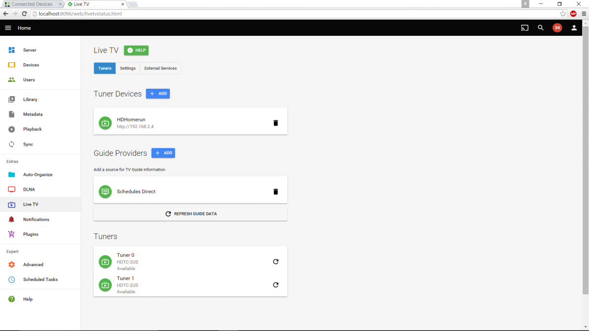

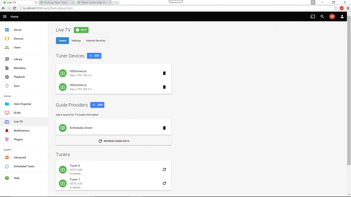

ls3 0 Posted March 13, 2016 Author Posted March 13, 2016 I checked the Live TV and it showed two HDHomerun (I only have one) and four tuners. So I erased the HDHR ending in .5 (Router shows the HDHR in .4). I did not resolved my issue. I still have the same error loading the guide and my option to record shows is missing Emby Log-2 031216.txt

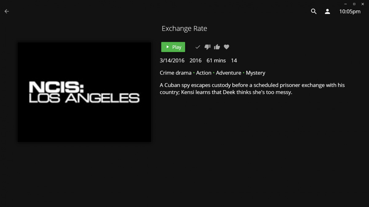

ls3 0 Posted March 15, 2016 Author Posted March 15, 2016 I used to be able to see it in this screen (see attached)
Luke 42186 Posted March 15, 2016 Posted March 15, 2016 ok, that is the new emby theater. it has not implemented recording features yet. try the regular web app or any other app that supports recording.
