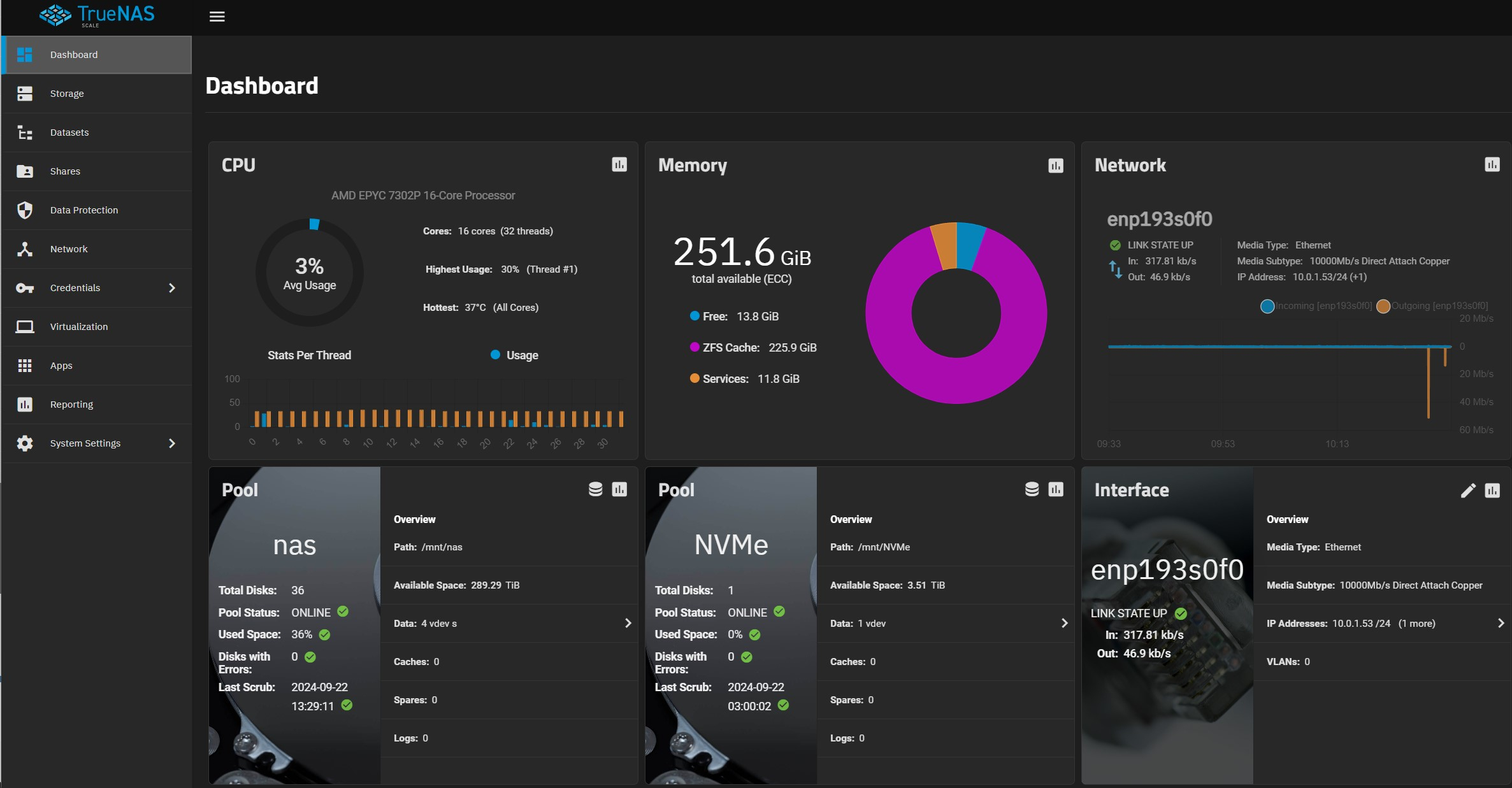

pclausen 44 Posted October 8, 2024 Posted October 8, 2024 That username is administrator. I actually tried that and weird things happened on my windows box with the share. Maybe that's a reserved username or something. Any any rate, I got the Emby app on TrueNAS to be able to see my media share. What threw me off at first is that the "browse for media location" didn't work, but typing in the path manually did. Currently scanning my TV Shows folder, which is taking a LONG time (370 shows, some with 20+ seasons). Server is barely breaking a sweat, but I'm guessing Emby going out and fetching all the metadata is what's taken so long: 1
