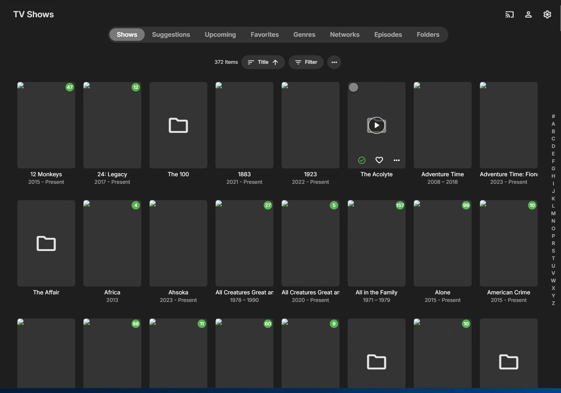

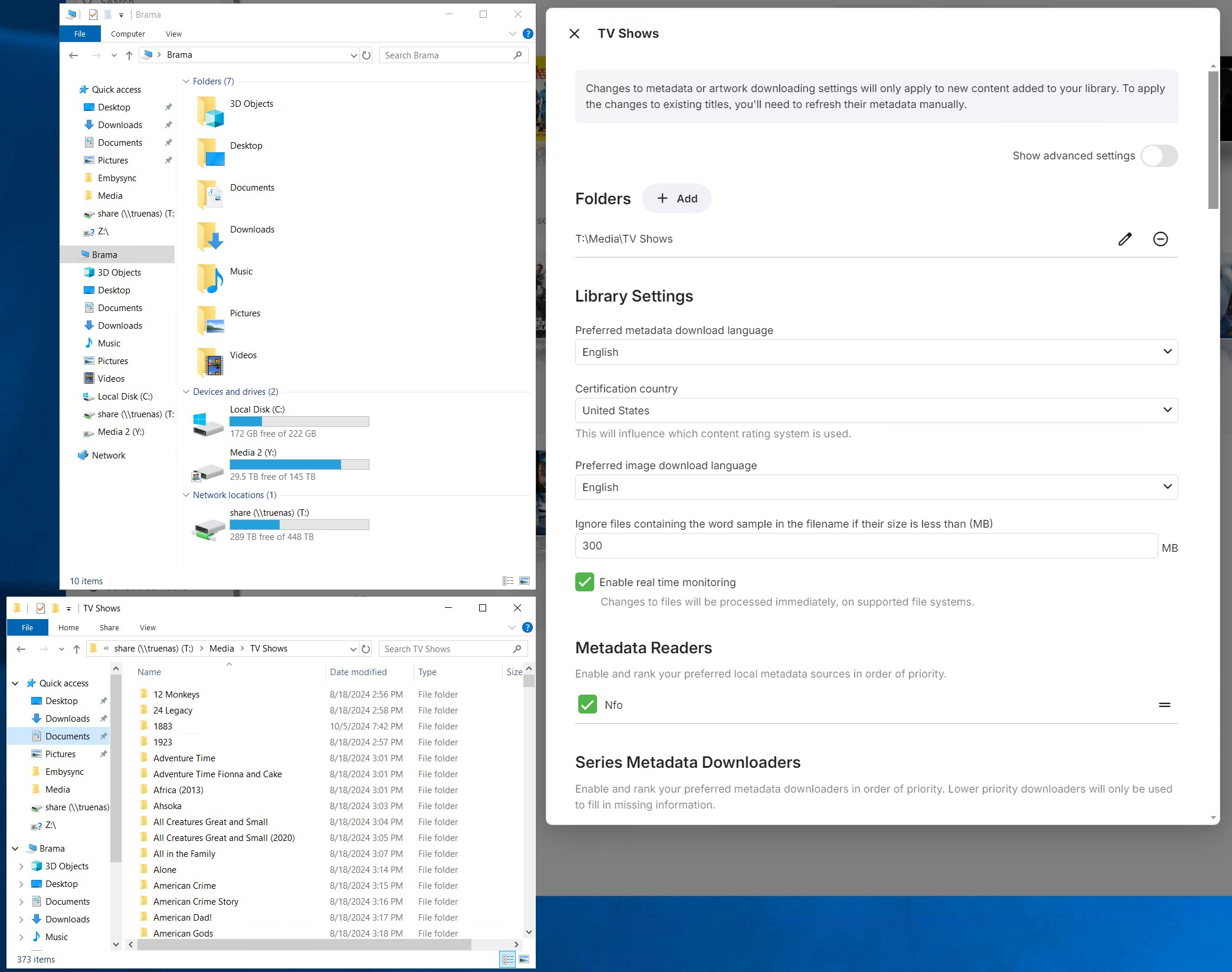

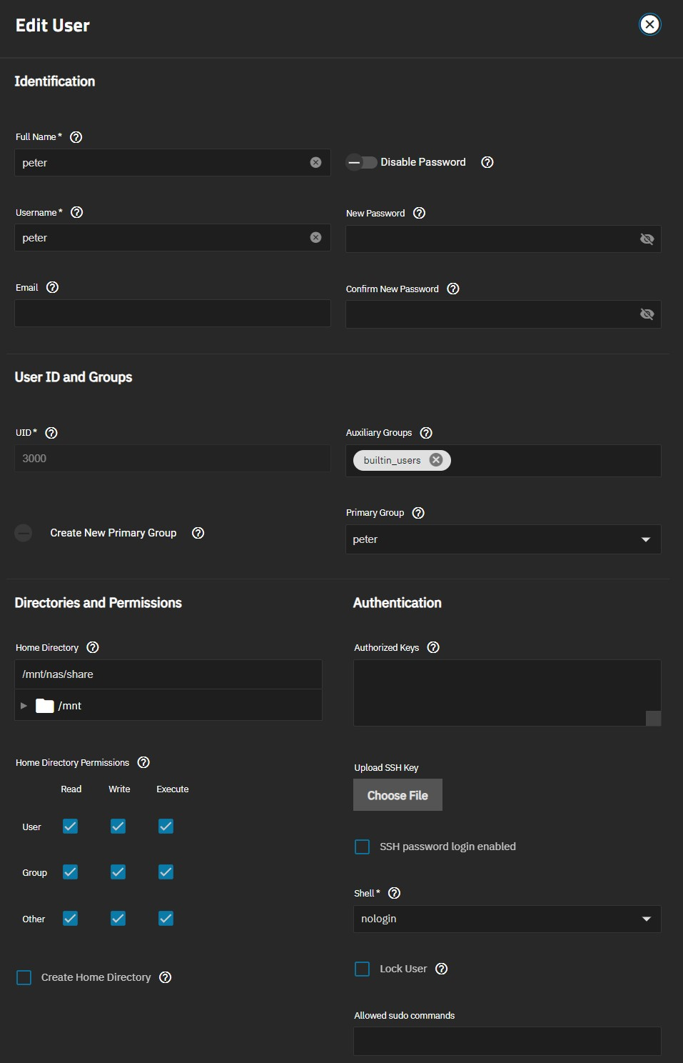

I have Emby server running on a windows server machine and up until recently all my media was stored locally and I had no issues.
I added a TrueNAS server on my network and created a user and share that I have mounted on the server running Emby.
It shows up just fine on my windows server machine and I was able to change one of my libraries to point to the new location:
Problem is that Emby does not appear to be able to write anything to the share.  So what user does Emby use when accessing a SMB share?
Right now I just have the 'peter' created on the TrueNAS box:
I'm guessing emby is not trying to use the 'peter' user when attempting to write to the SMB share?

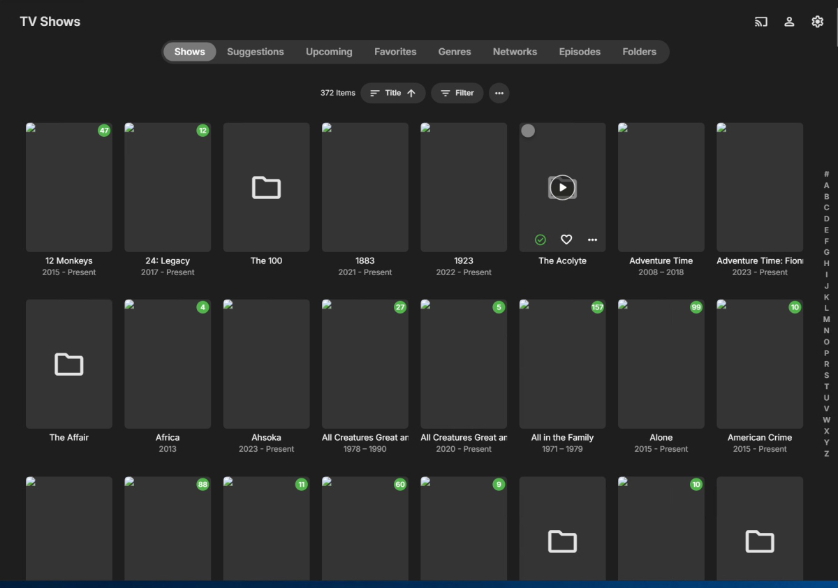

Actually, it doesn't look like its not able to read the contents either:
Eventually I'll install Emby as a plug-in on my TrueNAS box, but I want to get it working like this first before making that change.
Thanks!
