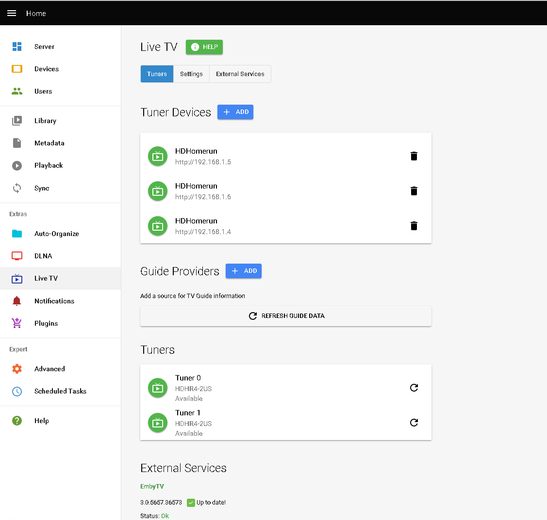

randombetrayal 0 Posted March 20, 2016 Author Posted March 20, 2016 The web interface is unchanged, It is un-watchable. It takes over a minute before any channel actually loads. The quality is so bad you can't watch it, frame rates is single digits and pixelated. This is a channel that is a couple miles away for over the air broadcast that the XBOX 360 had no problems with. I have attached the latest log after loading another live stream on the web interface of the server. I have attached screen shots of the settings as they currently are on the server and the latest transcode and server logs. server-63594092168.txt transcode-c5f2d111-008c-47f6-b8ee-d1fe0ba3f6eb.txt
Luke 42301 Posted March 20, 2016 Posted March 20, 2016 Browser playback is going to require transcoding and it looks like your system is just not powerful enough for that. You're going to want to focus your playback on apps that can direct play the live TV feed, like the windows version of emby theater for example.
randombetrayal 0 Posted March 23, 2016 Author Posted March 23, 2016 Browser playback is going to require transcoding and it looks like your system is just not powerful enough for that. You're going to want to focus your playback on apps that can direct play the live TV feed, like the windows version of emby theater for example. I can't believe this is the problem. The server has an i5 processor and 8 gigs of ram. The computer I would download theater too would only have a newer version of the i5. How are people streaming live TV to their Amazon fire with only pentiums? there has got to be something else bottlenecking it.
