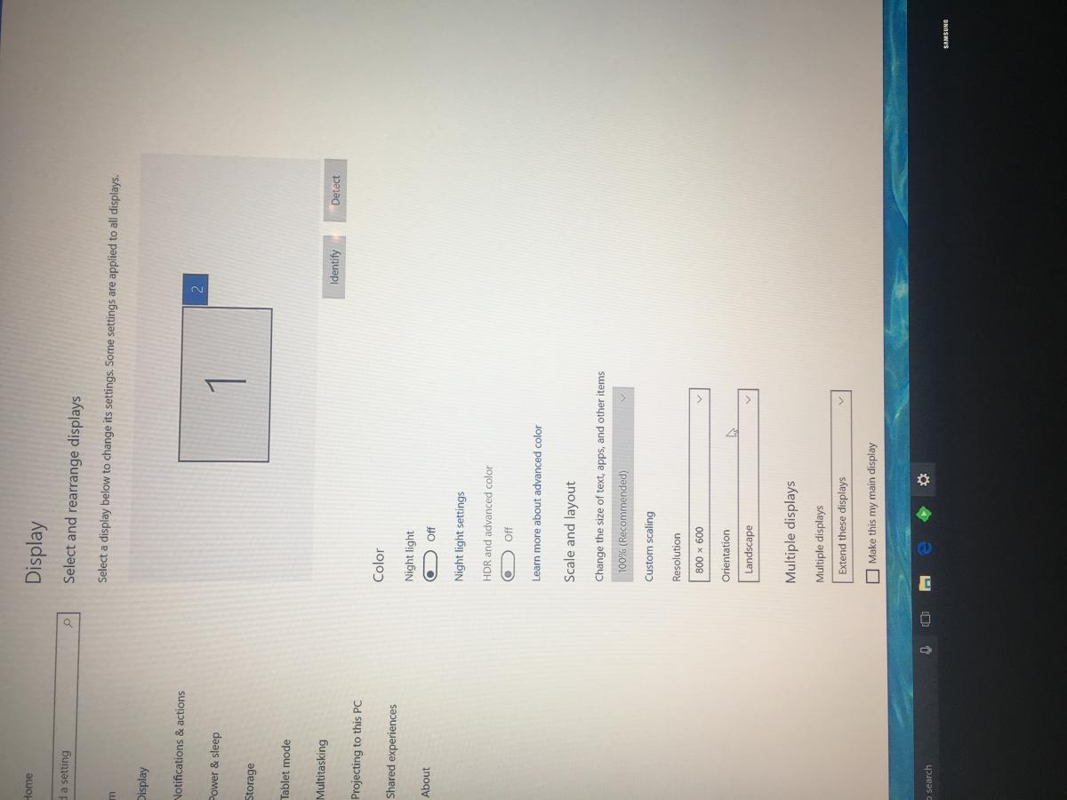

jjstecchino 8 Posted June 30, 2017 Posted June 30, 2017 Force resolution and 800x600 makes no difference. Agree now scaling seems right, but positioning is not. I noticed the position of the front view UI changes relative to the second monitor display area, depending on where you place the second monitor respect to the first, to clarify you get a different kind of front view displacement if you place display 2 on top right, top center, top left etc in display setting

GlennNZ 92 Posted June 30, 2017 Author Posted June 30, 2017 Glenn where in the code do you handle screen positioning and resolution? If you don't mind i'll be glad to take a look Its in Yatse2Window.cs - line 2519 Basically the issue is to calculate the screen position for the window takes X,Y cooridinates. With 100% scaling its easy - the X,Y for 2nd screen is one whole screen over and/or 0 depending. With scaling of the first screen there is a variable change in this X,Y value. The previous code to pull the DPI scaling - no longer seems to in Windows Creator Update. Really hard for me to test - because need a Windows 10 machine with two monitors which I don't have up and running. Have a solution now though - basically working around it. Give me a sec. Glenn
GlennNZ 92 Posted June 30, 2017 Author Posted June 30, 2017 (edited) Glenn where in the code do you handle screen positioning and resolution? If you don't mind i'll be glad to take a look Ok Heres Build 250 - which avoids the problem altogether by letting you override the screen positioning manually. Run Go into FrontVIew Settings and click Save to create new entries (may need it on 100% scaling to get access to) Within settings.xml are two new entries ScreenPositionX ScreenPositionY These are ignored if both 0 - and current behaviour continues. If these are not zero they are used for the final positon of the FrontView screen. Its hard to work out what they should be: But you working log (with 100% scaling) had them both at X at 0 Y at -600 200% scaling - FrontView was using X at 0 Y at -1200 Hoping setting them to X/Y first works Sorry have X and Y reversed - will fix But for moment just use reverse Glenn FrontView.zip Edited June 30, 2017 by GlennNZ
jjstecchino 8 Posted June 30, 2017 Posted June 30, 2017 Allright, this is crazy! I thought windows coords system were (0,0) on Top, Left, x -> horizontal, y -> vertical. I was able to correctly position the front view ui with a ScreenPositionX= -600, Y=0, scaling 150% Do you have x and y inverted somewhere?
GlennNZ 92 Posted June 30, 2017 Author Posted June 30, 2017 Allright, this is crazy! I thought windows coords system were (0,0) on Top, Left, x -> horizontal, y -> vertical. I was able to correctly position the front view ui with a ScreenPositionX= -600, Y=0, scaling 150% Do you have x and y inverted somewhere? Sorry - had to keep you on your toes! You obviously missed my edited post above - yep X/Y reverse. Will fix. That's interesting that the old scaling 600 etc (100%) works - so essentially probably need to get the DPI scaling amounts through another mechanism and divide to go back. (the previous DPI get method does not work on your system - and I have tried a couple) Glenn
