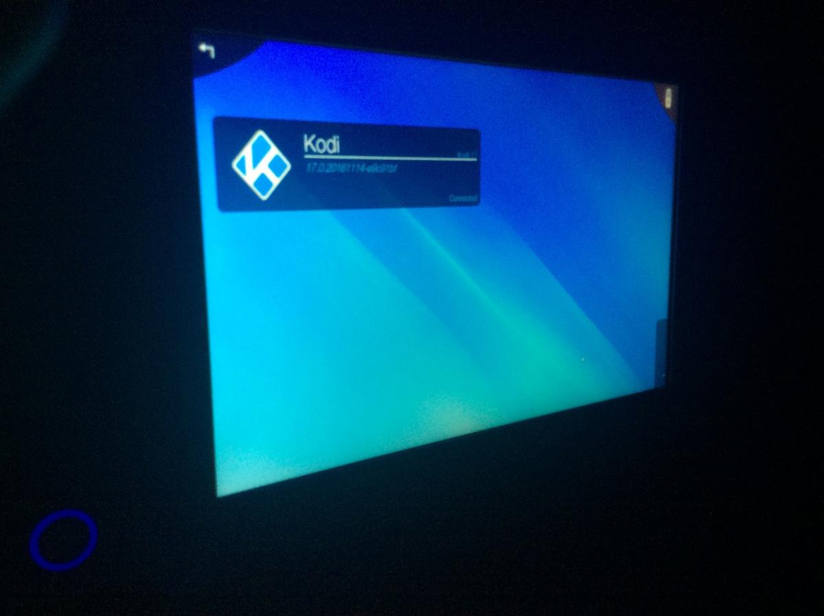

Windsurfer79 0 Posted November 21, 2016 Posted November 21, 2016 Hi Not sure I follow. (at very low resolution 640x480 some menu in settings will be cut-off) A picture is probably needed to help explain what you mean. Glenn I Hope this will help you. All the Menues are cut off. Screen Resolution is 1200x800. Same is configured in frontview
GlennNZ 92 Posted November 21, 2016 Author Posted November 21, 2016 I Hope this will help you. All the Menues are cut off. Screen Resolution is 1200x800. Same is configured in frontview Its very likely your monitors and Windows DPI Setting - needs to be 1.0 or 100% for maximum compatibility (Had made a few changes to make more multi-DPI aware; but was a bit of hornets nest so hadn't moved forward with it) http://www.sevenforums.com/tutorials/443-dpi-display-size-settings-change.html See the above link for your version of windows. Let me know how you go. Glenn
