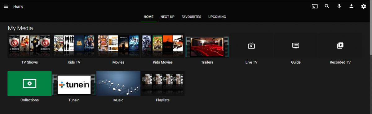

Ice 23 Posted February 4, 2016 Posted February 4, 2016 Sorry I was posting in the Linux thread instead of the windows thread so I will just add everything to this post Ice: My server completed the update ok but now the automatic grouping of similar content no longer seems to be working. Luke: Double check your user settings by clicking your user icon in the top right Ice: I have, I tried unticking the option restarting the server then reticking the option an restarting the server still the same. I see there is another update I will see how it is going after that Ice: Still the same problem with 3.0.5864.0 installed Luke: can you show a screenshot of your issue? i'm a little unclear. thanks. Ice:

Ice 23 Posted February 4, 2016 Author Posted February 4, 2016 (edited) This is OT but I just checked group my Kids TV and TV, and Kids Movies and Movies and hit save. Refreshed the page to regenerate View Order, then went to home screen and Kids TV and TV were grouped to TV and Kids Movies and Movies were grouped to Movies. You may have to refresh your browser. I have done that but with no success, I even changed browsers to see if that made a difference also my android phone running Emby software has the same problem so I don't think it has anything to do with device or browser used to connect to my Emby Server (Windows 7 Ultimate 64bit, Intel Core 2 Quad 9450, 4GB ram, (edit: 240GB SSD boot device), 20TB storage, also running the addon for MC) Edited February 4, 2016 by Ice

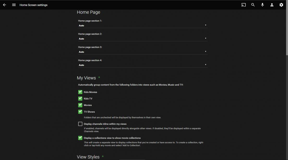

Happy2Play 9800 Posted February 4, 2016 Posted February 4, 2016 Can you post a clean server log of you changing the My View options. When I make the change I see it in the log. 2016-02-04 14:09:32.2921 Info HttpServer: HTTP Response 200 to 192.168.151.7. Time: 0ms. http://whs2011-home:8096/emby/Users/adfb2b8054354e6890279175177c4721/GroupingOptions2016-02-04 14:09:32.4637 Info HttpServer: HTTP Response 200 to 192.168.151.7. Time: 187ms. http://whs2011-home:8096/emby/Users/adfb2b8054354e6890279175177c4721/Views2016-02-04 14:09:32.5573 Debug App: Running DynamicImageProvider for Z:\ServerFolders\Emby-Server\metadata\views\0d9408ac29e958ff792d6f6c64652af12016-02-04 14:09:32.7445 Info ImageProcessor: Creating image collage and saving to C:\Users\Administrator\AppData\Roaming\Emby-Server\cache\temp\e8936c6b0f534f6daef51cdd0527206a.png2016-02-04 14:09:33.3373 Info ImageProcessor: Completed creation of image collage and saved to C:\Users\Administrator\AppData\Roaming\Emby-Server\cache\temp\e8936c6b0f534f6daef51cdd0527206a.png2016-02-04 14:09:33.3685 Debug ProviderManager: Saving image to Z:\ServerFolders\Emby-Server\metadata\library\0d\0d9408ac29e958ff792d6f6c64652af1\poster.png2016-02-04 14:09:33.3841 Debug App: Saving Z:\ServerFolders\Emby-Server\metadata\views\0d9408ac29e958ff792d6f6c64652af1 to database.2016-02-04 14:09:33.4933 Debug App: Running DynamicImageProvider for Z:\ServerFolders\Emby-Server\metadata\views\2700de053250bee07b245a0b93ae3b742016-02-04 14:09:33.5245 Info ImageProcessor: Creating image collage and saving to C:\Users\Administrator\AppData\Roaming\Emby-Server\cache\temp\c18d7075c47d4518916e15af3a71df83.png2016-02-04 14:09:33.9769 Info ImageProcessor: Completed creation of image collage and saved to C:\Users\Administrator\AppData\Roaming\Emby-Server\cache\temp\c18d7075c47d4518916e15af3a71df83.png2016-02-04 14:09:33.9769 Debug ProviderManager: Saving image to Z:\ServerFolders\Emby-Server\metadata\library\27\2700de053250bee07b245a0b93ae3b74\poster.png2016-02-04 14:09:33.9769 Debug App: Saving Z:\ServerFolders\Emby-Server\metadata\views\2700de053250bee07b245a0b93ae3b74 to database.2016-02-04 14:09:34.0861 Debug App: Running DynamicImageProvider for Z:\ServerFolders\Emby-Server\metadata\views\dd21a74bc36450c9349dfb010b30afe92016-02-04 14:09:34.0861 Debug App: Saving Z:\ServerFolders\Emby-Server\metadata\views\dd21a74bc36450c9349dfb010b30afe9 to database.2016-02-04 14:09:34.1953 Debug App: Running DynamicImageProvider for Z:\ServerFolders\Emby-Server\metadata\views\901ee04951050093ebd140fe9297eebc2016-02-04 14:09:34.1953 Debug App: Saving Z:\ServerFolders\Emby-Server\metadata\views\901ee04951050093ebd140fe9297eebc to database.2016-02-04 14:09:34.3045 Debug App: Running DynamicImageProvider for Z:\ServerFolders\Emby-Server\metadata\views\771163dc8f6add65493ceb9f3621b81f2016-02-04 14:09:34.3045 Debug App: Saving Z:\ServerFolders\Emby-Server\metadata\views\771163dc8f6add65493ceb9f3621b81f to database.2016-02-04 14:09:34.4137 Debug App: Running DynamicImageProvider for Z:\ServerFolders\Emby-Server\metadata\views\b1fa63ad9e0ce2f3a58ba4d25f481cea2016-02-04 14:09:34.4137 Debug App: Saving Z:\ServerFolders\Emby-Server\metadata\views\b1fa63ad9e0ce2f3a58ba4d25f481cea to database.2016-02-04 14:09:34.5229 Debug App: Running DynamicImageProvider for Z:\ServerFolders\Emby-Server\metadata\views\8f9000445d05f9a5846c5e3eeceb2a292016-02-04 14:09:34.5229 Debug App: Saving Z:\ServerFolders\Emby-Server\metadata\views\8f9000445d05f9a5846c5e3eeceb2a29 to database.2016-02-04 14:09:34.6321 Debug App: Running DynamicImageProvider for Z:\ServerFolders\Emby-Server\metadata\views\75fe09b9196b37a2145c9b54852efa602016-02-04 14:09:34.6321 Debug App: Saving Z:\ServerFolders\Emby-Server\metadata\views\75fe09b9196b37a2145c9b54852efa60 to database.2016-02-04 14:09:34.7413 Debug App: Running DynamicImageProvider for Z:\ServerFolders\Emby-Server\metadata\views\f4301925c7d0593fae11b6f2c98e3fbd2016-02-04 14:09:34.7413 Debug App: Saving Z:\ServerFolders\Emby-Server\metadata\views\f4301925c7d0593fae11b6f2c98e3fbd to database.2016-02-04 14:09:34.8505 Debug App: Running DynamicImageProvider for Z:\ServerFolders\Emby-Server\metadata\views\5a95beb23d079091e712522e7ce90d022016-02-04 14:09:34.8505 Debug App: Saving Z:\ServerFolders\Emby-Server\metadata\views\5a95beb23d079091e712522e7ce90d02 to database.2016-02-04 14:09:34.9597 Debug App: Running DynamicImageProvider for Z:\ServerFolders\Emby-Server\metadata\views\4df153855be6137eff9b076dc3f175662016-02-04 14:09:34.9597 Debug App: Saving Z:\ServerFolders\Emby-Server\metadata\views\4df153855be6137eff9b076dc3f17566 to database.2016-02-04 14:09:35.0689 Debug App: Running DynamicImageProvider for Z:\ServerFolders\Emby-Server\metadata\views\15d9671272ec1a202cb3f66f8ac3696e2016-02-04 14:09:35.0689 Debug App: Saving Z:\ServerFolders\Emby-Server\metadata\views\15d9671272ec1a202cb3f66f8ac3696e to database.2016-02-04 14:09:35.1781 Debug App: Running DynamicImageProvider for Z:\ServerFolders\Emby-Server\metadata\views\1c55c66db3f3dab3da901f5241bcb47a2016-02-04 14:09:35.1781 Debug App: Saving Z:\ServerFolders\Emby-Server\metadata\views\1c55c66db3f3dab3da901f5241bcb47a to database.
Luke 42186 Posted February 5, 2016 Posted February 5, 2016 How are the view styles below configured? it shouldn't matter but i'm just curious. thanks.
Ice 23 Posted February 6, 2016 Author Posted February 6, 2016 How are the view styles below configured? it shouldn't matter but i'm just curious. thanks. I have all view styles unticked
Happy2Play 9800 Posted February 6, 2016 Posted February 6, 2016 Okay I can replicate if view styles are disabled, you are unable to group content type folders.
Ice 23 Posted February 6, 2016 Author Posted February 6, 2016 Can you post a clean server log of you changing the My View options. When I make the change I see it in the log. 2016-02-04 14:09:32.2921 Info HttpServer: HTTP Response 200 to 192.168.151.7. Time: 0ms. http://whs2011-home:8096/emby/Users/adfb2b8054354e6890279175177c4721/GroupingOptions 2016-02-04 14:09:32.4637 Info HttpServer: HTTP Response 200 to 192.168.151.7. Time: 187ms. http://whs2011-home:8096/emby/Users/adfb2b8054354e6890279175177c4721/Views 2016-02-04 14:09:32.5573 Debug App: Running DynamicImageProvider for Z:\ServerFolders\Emby-Server\metadata\views\0d9408ac29e958ff792d6f6c64652af1 2016-02-04 14:09:32.7445 Info ImageProcessor: Creating image collage and saving to C:\Users\Administrator\AppData\Roaming\Emby-Server\cache\temp\e8936c6b0f534f6daef51cdd0527206a.png 2016-02-04 14:09:33.3373 Info ImageProcessor: Completed creation of image collage and saved to C:\Users\Administrator\AppData\Roaming\Emby-Server\cache\temp\e8936c6b0f534f6daef51cdd0527206a.png 2016-02-04 14:09:33.3685 Debug ProviderManager: Saving image to Z:\ServerFolders\Emby-Server\metadata\library\0d\0d9408ac29e958ff792d6f6c64652af1\poster.png 2016-02-04 14:09:33.3841 Debug App: Saving Z:\ServerFolders\Emby-Server\metadata\views\0d9408ac29e958ff792d6f6c64652af1 to database. 2016-02-04 14:09:33.4933 Debug App: Running DynamicImageProvider for Z:\ServerFolders\Emby-Server\metadata\views\2700de053250bee07b245a0b93ae3b74 2016-02-04 14:09:33.5245 Info ImageProcessor: Creating image collage and saving to C:\Users\Administrator\AppData\Roaming\Emby-Server\cache\temp\c18d7075c47d4518916e15af3a71df83.png 2016-02-04 14:09:33.9769 Info ImageProcessor: Completed creation of image collage and saved to C:\Users\Administrator\AppData\Roaming\Emby-Server\cache\temp\c18d7075c47d4518916e15af3a71df83.png 2016-02-04 14:09:33.9769 Debug ProviderManager: Saving image to Z:\ServerFolders\Emby-Server\metadata\library\27\2700de053250bee07b245a0b93ae3b74\poster.png 2016-02-04 14:09:33.9769 Debug App: Saving Z:\ServerFolders\Emby-Server\metadata\views\2700de053250bee07b245a0b93ae3b74 to database. 2016-02-04 14:09:34.0861 Debug App: Running DynamicImageProvider for Z:\ServerFolders\Emby-Server\metadata\views\dd21a74bc36450c9349dfb010b30afe9 2016-02-04 14:09:34.0861 Debug App: Saving Z:\ServerFolders\Emby-Server\metadata\views\dd21a74bc36450c9349dfb010b30afe9 to database. 2016-02-04 14:09:34.1953 Debug App: Running DynamicImageProvider for Z:\ServerFolders\Emby-Server\metadata\views\901ee04951050093ebd140fe9297eebc 2016-02-04 14:09:34.1953 Debug App: Saving Z:\ServerFolders\Emby-Server\metadata\views\901ee04951050093ebd140fe9297eebc to database. 2016-02-04 14:09:34.3045 Debug App: Running DynamicImageProvider for Z:\ServerFolders\Emby-Server\metadata\views\771163dc8f6add65493ceb9f3621b81f 2016-02-04 14:09:34.3045 Debug App: Saving Z:\ServerFolders\Emby-Server\metadata\views\771163dc8f6add65493ceb9f3621b81f to database. 2016-02-04 14:09:34.4137 Debug App: Running DynamicImageProvider for Z:\ServerFolders\Emby-Server\metadata\views\b1fa63ad9e0ce2f3a58ba4d25f481cea 2016-02-04 14:09:34.4137 Debug App: Saving Z:\ServerFolders\Emby-Server\metadata\views\b1fa63ad9e0ce2f3a58ba4d25f481cea to database. 2016-02-04 14:09:34.5229 Debug App: Running DynamicImageProvider for Z:\ServerFolders\Emby-Server\metadata\views\8f9000445d05f9a5846c5e3eeceb2a29 2016-02-04 14:09:34.5229 Debug App: Saving Z:\ServerFolders\Emby-Server\metadata\views\8f9000445d05f9a5846c5e3eeceb2a29 to database. 2016-02-04 14:09:34.6321 Debug App: Running DynamicImageProvider for Z:\ServerFolders\Emby-Server\metadata\views\75fe09b9196b37a2145c9b54852efa60 2016-02-04 14:09:34.6321 Debug App: Saving Z:\ServerFolders\Emby-Server\metadata\views\75fe09b9196b37a2145c9b54852efa60 to database. 2016-02-04 14:09:34.7413 Debug App: Running DynamicImageProvider for Z:\ServerFolders\Emby-Server\metadata\views\f4301925c7d0593fae11b6f2c98e3fbd 2016-02-04 14:09:34.7413 Debug App: Saving Z:\ServerFolders\Emby-Server\metadata\views\f4301925c7d0593fae11b6f2c98e3fbd to database. 2016-02-04 14:09:34.8505 Debug App: Running DynamicImageProvider for Z:\ServerFolders\Emby-Server\metadata\views\5a95beb23d079091e712522e7ce90d02 2016-02-04 14:09:34.8505 Debug App: Saving Z:\ServerFolders\Emby-Server\metadata\views\5a95beb23d079091e712522e7ce90d02 to database. 2016-02-04 14:09:34.9597 Debug App: Running DynamicImageProvider for Z:\ServerFolders\Emby-Server\metadata\views\4df153855be6137eff9b076dc3f17566 2016-02-04 14:09:34.9597 Debug App: Saving Z:\ServerFolders\Emby-Server\metadata\views\4df153855be6137eff9b076dc3f17566 to database. 2016-02-04 14:09:35.0689 Debug App: Running DynamicImageProvider for Z:\ServerFolders\Emby-Server\metadata\views\15d9671272ec1a202cb3f66f8ac3696e 2016-02-04 14:09:35.0689 Debug App: Saving Z:\ServerFolders\Emby-Server\metadata\views\15d9671272ec1a202cb3f66f8ac3696e to database. 2016-02-04 14:09:35.1781 Debug App: Running DynamicImageProvider for Z:\ServerFolders\Emby-Server\metadata\views\1c55c66db3f3dab3da901f5241bcb47a 2016-02-04 14:09:35.1781 Debug App: Saving Z:\ServerFolders\Emby-Server\metadata\views\1c55c66db3f3dab3da901f5241bcb47a to database. I don't see anything like that in my log file
Ice 23 Posted February 6, 2016 Author Posted February 6, 2016 Okay I can replicate if view styles are disabled, you are unable to group content type folders. Ok then, well I don't want view styles enabled I find them annoying, also it wasn't a problem with earlier versions
Ice 23 Posted February 6, 2016 Author Posted February 6, 2016 Okay I can replicate if view styles are disabled, you are unable to group content type folders. yes I just tested this and it works if I turn view styles on but like I said I don't want them turned on
