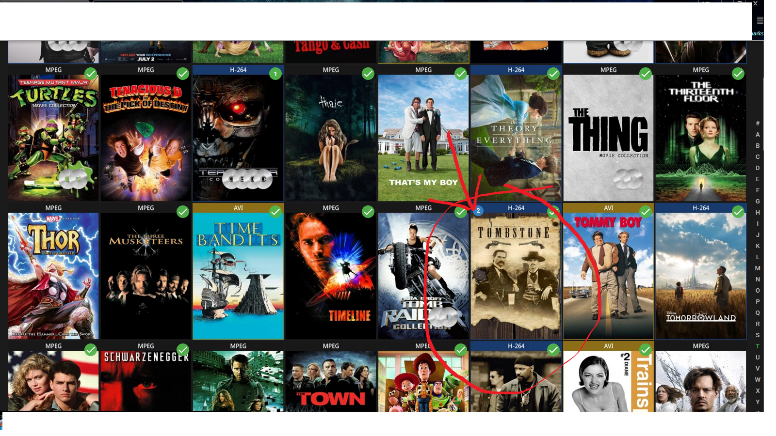

Jack Burton 98 Posted February 5, 2016 Author Posted February 5, 2016 Thanx for the help. Recent changes seem to have made an impact, looks great! Of course, noticed one small thing so far, and not the biggest deal. Anyway, a few movies came out of collections again and are now back in without me doing anything, so that's perfect. However, I have one movie, Tombstone, which I have 2 copies of (one theatrical and one with additional scenes, it's really awesome btw). Since both movies are technically the same (tmdb won't differentiate), it's now put both copies together so I can only access one. The poster has a blue 2 in the top left corner.
