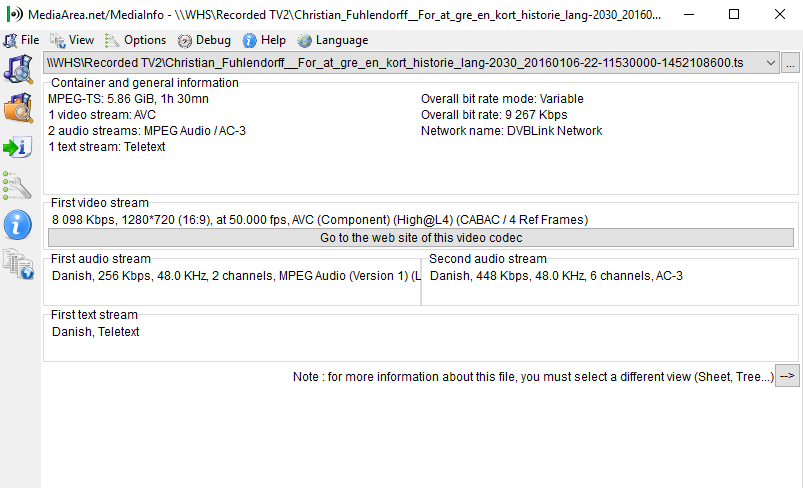

Notfast 7 Posted January 31, 2016 Posted January 31, 2016 (edited) I have the same problem - now my live TV gets transcoded - Im sure that it used to be stream as streamcopy. Im using a chormecast. Here is what my settop box from my provider support : ------------------------------- MPEG-2 (SD and HD): Transport stream - PAT, PMT, video and audio streams, constant and variable bit rate, 2-25 Mbps, up to MP@HL 1080i@60 fps H.264 (SD and HD): PAT, PMT, video and audio streams, up to 20 Mbps, up to HP@L4.1 (1080i@60 fps) High Definition video: 1280x720@50 or 60 fps (progressive scan) 1920x1080@50 or 60 fps (interlaced scan) Streaming Audio Audio Types: MPEG (Layer 1, 2, 3), PCM, AC3, AAC ------------------------------- So .ts H.264 720p50 should be play able with just streamcopy (.ts container to .mp4). .ts H.264 1080i50 just need deinterlace + streamcopy (.ts container to .mp4), yadif=0 should do it I think This will free up a lot of load on my server!I´m using dvblogic for my TV. server-63589863699.txt transcode-8f6e0ec5-9bde-4420-a68d-776ef94ff3e4.txt Edited January 31, 2016 by Notfast
