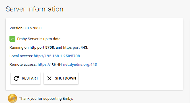

Fratopolis 64 Posted January 24, 2016 Posted January 24, 2016 Not a huge deal for me as I use dyndns but (emby connect) has only worked the first day I tried it. Proceeded to buy the product anyway since it rocks. Do not want people spending too much time on me with this as it is not dier. When I use emby connect out side my network it literally tries to connect to the local address which obviously will not work. It tries to connect to the 192.168.1.250 and not the remote address.
Luke 42186 Posted January 24, 2016 Posted January 24, 2016 Not a huge deal for me as I use dyndns but (emby connect) has only worked the first day I tried it. Proceeded to buy the product anyway since it rocks. Do not want people spending too much time on me with this as it is not dier. When I use emby connect out side my network it literally tries to connect to the local address which obviously will not work. It tries to connect to the 192.168.1.250 and not the remote address. It's normal. It tests the manual address (if entered), then local and remote. This way you are always connected via the most efficient way. There isn't always a foolproof way to determine if you're on the local network or not. The only method that will always work is testing and reacting to the result.
Fratopolis 64 Posted January 24, 2016 Posted January 24, 2016 It's normal. It tests the manual address (if entered), then local and remote. This way you are always connected via the most efficient way. There isn't always a foolproof way to determine if you're on the local network or not. The only method that will always work is testing and reacting to the result. gotcha thanks. I'll continue with dyndns then since the connect does not try the remote address which is the dyndns address. As I said not a huge deal. Side note, do you ever sleep Luke!!!!?
Fratopolis 64 Posted January 24, 2016 Posted January 24, 2016 Someone shoot me now. Saw "Report https as external address" was ticked. OMG so unticked and working LMFAO, then ticked back on once I setup my cert and all is well in the world. Luke you have my permission to knock me out. Imma bout to cry for being so dumb. Continually overlooked that. 2
