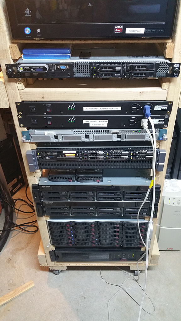

JeremyFr79 228 Posted January 25, 2016 Posted January 25, 2016 Jeremy, Well do you mind giving me the specs of your personal server? case Motherboard Processors ram etc? I am like you - I build in excess Also what is the new quicksync feature you mention? Is that something in Emby? My Emby Server is a Dell R810, running (4) Intel Xeon L7555 Processors (1.87Ghz 8 Core/16 Threads) 128GB of DDR3 FBDIMM Memory, (2) 15k 146GB SAS drives (mirrored for OS and software) (1) 15k 300GB SAS Drive (WIndows Page File) (3) 10k 900GB SAS Drives (RAID5-Emby cache/metadata/transcoding) Mind you this is a wholly dedicated server to Emby, all media is stored on a separate SAN setup in the rack currently consisting of a main file server with (24) Drives and (2) 8 Bay QNap Enclosures for a total of 40 storage drives running in 4 different RAID arrays yielding around 75TB of storage total from nearly 100TB of actual disks. Quicksync is support to use the integrated GPU on Intels "consumer" chips to do the work for transcoding thus freeing up the main CPU to do other things.
JDCaduceus 1 Posted January 25, 2016 Author Posted January 25, 2016 (edited) gtocha - so you did a Dell build and not a custom build? What motherboard or Dell propietary? Thanks for the intel - I have 4 Synology servers running 48 drives on raid 1 for 125tb of space - I need a dedicated emby server and I think reading your specs I like what you have. how did you set up your hard drives on the server to interact with yoru SAN setup? You have 6 drives on your server 1 drive for just cache, metadata and transcoding? I have all of my metadata and cache for each movie file on my synology - so I would not need that feature. How much did this run you for the dell? What OS are you using on the dell? I love it! Do you have a monitor that is part of your rack system to allow you to configure the dell? Edited January 25, 2016 by JDCaduceus
JeremyFr79 228 Posted January 25, 2016 Posted January 25, 2016 Ok..... Yes the Dell is all propietary as all Dell's are (servers anyways) The Dell is running WIndows Server2008R2 (been too lazy to upgrade it to 2012R2 like my other servers) I used to work manage data centers for a large internet company and as such got to take home some pretty sweet hardware when it came time to de-commission it at no charge so I didn't pay a dime for the Dell. As for connectivity, I'll try to explain this best I can. The main fileserver is running Windows Server 2012R2, it has a total of 6 Gigabit network connections, 4 of these are used for ISCSI connections to the QNAP arrays 2 connections each forming a true 2Gbps Bonded connection between the server and each san. So I get 225MBps of read/write performance to each QNAP because they are each on dedicated ISCSI links that's simultaneously so I can read/write 225MBps to each Qnap at the same time for a total of 450MBps read/write between the 2 arrays and the server. The final 2 gigabit connections are running a bonded connection back to my main network switch, the Dell also has a 2Gbps bonded connection to the same switch. Yes I have a monitor and KVM for configuration etc of all the servers in the rack though most everything I normally do via Remote Desktop.

JDCaduceus 1 Posted January 25, 2016 Author Posted January 25, 2016 jusst did a search on R810 and prices are all over the place depending on packages (processors, ram and HD configs) - just need to do research. One question are you running two Dell Servers on your rack? One for outsourcing to your users and one for you internally? Are those power supplies on the WAN disconnect?
JeremyFr79 228 Posted January 25, 2016 Posted January 25, 2016 Ok so in the pic I posted above it's as follows. Custom built HTPC - handles all TV recording (8 tuners total) and runs the Theater room on the other side of the wall. Dell PowerEdge 1950 - Router - runs PFSense Firewall/Router and handles all the firewall/routing/etc for the house. Curenntly running 5 VLANS (main, iscsi,security cameras, guest wireless, VPN) (2) Leviton 120 volt 15amp PDU's Cisco UCS Server - Server 2012R2 - DC/DNS this runs all DNS for the house and is the Domain controller. Dell R810 - Emby Server (2) Qnap TS-879u - each has (8) 3TB Hitachi Ultrastar drives each running in RAID 5 Supermicro Chassis with dual Xeon L5520 CPU's 48GB RAM, 9x3TB RAID 6, 3x1TB RAID 5, 12x1TB RAID 6
