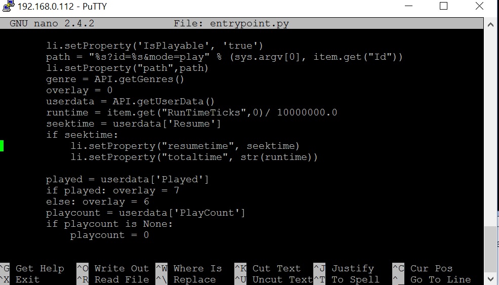

xnappo 1611 Posted January 23, 2016 Posted January 23, 2016 (edited) Hi, Please open addons/plugin.video.emby/resources/lib/entrypoint.py and change line 531 from: li.setProperty("resumetime", seektime) to li.setProperty("resumetime", str(seektime)) Let me know. xnappo Edited January 23, 2016 by xnappo

chrisoldroyd 12 Posted January 23, 2016 Author Posted January 23, 2016 @@xnappo I have managed to find the file and line but its slightly different to what you quoted so can you confirm what I need to edit please?
xnappo 1611 Posted January 23, 2016 Posted January 23, 2016 My bad. Change: li.setProperty("resumetime", seektime) to: li.setProperty("resumetime", str(seektime)) 1
chrisoldroyd 12 Posted January 23, 2016 Author Posted January 23, 2016 Actually scratch that, I have done it now, do I need to do any database sync ups or should it now just work? Thanks Chris 1
chrisoldroyd 12 Posted January 23, 2016 Author Posted January 23, 2016 Ok I will test and let you know, thank you 1
chrisoldroyd 12 Posted January 23, 2016 Author Posted January 23, 2016 Awesome, it now works, I bow down to your amazingness! 1
xnappo 1611 Posted January 23, 2016 Posted January 23, 2016 Thanks for testing - now you know a little more too Will check in to Git for next release. 4
