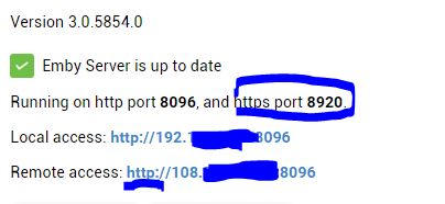

Bart91106 2 Posted January 31, 2016 Posted January 31, 2016 Running 3.0.5854.0 remote access is listed as "HTTP" vs "HTTPS"?? I can't connect to via remote access(Emby Connect) since my setting are for HTTPS. Also the port for remote acess is listed as "8096" vs "8920". Was the port changed? Thanks
Happy2Play 9800 Posted January 31, 2016 Posted January 31, 2016 (edited) Running 3.0.5854.0 remote access is listed as "HTTP" vs "HTTPS"?? I can't connect to via remote access(Emby Connect) since my setting are for HTTPS. Also the port for remote acess is listed as "8096" vs "8920". Was the port changed? Thanks Go to Dashboard-Advanced-Hosting and check "Report https as external address". Edited January 31, 2016 by Happy2Play
Luke 42186 Posted February 1, 2016 Posted February 1, 2016 And then after doing see please see post #2
Bart91106 2 Posted February 1, 2016 Posted February 1, 2016 Thanks! I updated the "Report https as external address". The Emby server remote address now matches remote address in my router, however I'm still not able to connect remotely via the Emby app (android). It discovers my server, however when I click on it I receive the error "Connection Failure" "We're unable to connect to the selected server..... Please verify..." I'm at my PC and have the server open. For now it appears this function doesn't work.
