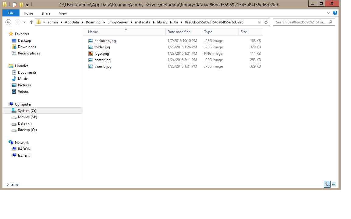

Luke 42301 Posted January 27, 2016 Posted January 27, 2016 if you open the detail page you'll see the id on the query string in the browser. Ā please open the server's program data folder, then navigate to /metadata/library. Then locate the sub-folder for that id. First there will be a folder based on the first two characters, then another layer with the full id. please post a screenshot of the contents of the folder. thanks.
revengineer 142 Posted January 28, 2016 Author Posted January 28, 2016 The screenshot is attached. Looking at these images, the poster.jpg one looks like the primary that shows when I delete the primary image and then do a refresh. The folder.jpg looks like the one I previously manually downloaded.
Luke 42301 Posted January 28, 2016 Posted January 28, 2016 try downloading it again. the issue is that poster.ext takes priority #1, but it was saving as folder.ext, so later on a refresh would restore poster as the primary image.
revengineer 142 Posted January 28, 2016 Author Posted January 28, 2016 I am actually fine with either image showing, the problem is that none of them were displayed leaving a completely black tile on the movie selection screen. Ā The funny thing is that now that I did the refresh, the tile shows with the poster.jpg image. I did a scan and a clean database and the image is still there. This is when I marked the issue as fixed as few days ago.Ā Ā However, I am pretty confident that by tomorrow or so the tile image will disappear again. Nothing I can do now but I will report back when that happens.Ā Ā Thanks for your patience.
Luke 42301 Posted January 28, 2016 Posted January 28, 2016 poster gets priority over folder. the bug that was occurring before was that the downloading process was saving as folder but the scanning process was picking poster. So at some point down the line when the content is rescanned, it reverts back to poster. In the new release the download process has been changed to save as poster. So if you download again that will correct the issue permanently. Ā If you want to try to find a way to automate this, what you could do is a mass rename of all folder.ext to poster.ext underneath the server's metadata/library folder, and then run a library scan.

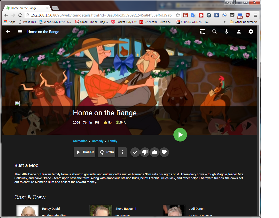

revengineer 142 Posted January 29, 2016 Author Posted January 29, 2016 After it was working yesterday, today the image is gone again. Please see attached screenshot. The content of the metadata folder is unchanged, the time stamps on the images is the same as yesterday. Now what?
revengineer 142 Posted January 30, 2016 Author Posted January 30, 2016 Luke, please see post above. Do you have any other ideas what could be causing the problem to return? Initially it seemed to have been the media scan that caused it but that appears to be fixed. Something else must be running overnight that causes the primary image to disappear (even though the image folder.jpg and poster.jpg images are still in the database. Thank you.
