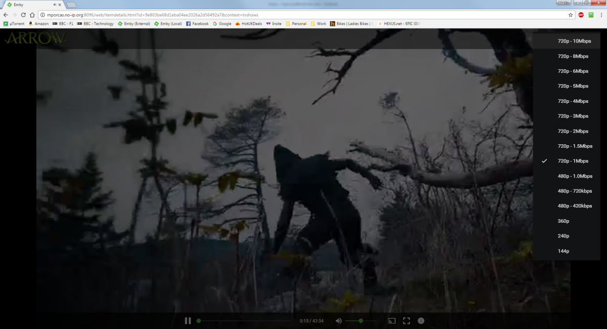

mporcas 3 Posted January 6, 2017 Posted January 6, 2017 (edited) Hi @@Luke Tried setting it down to 1mbps (60 doesn't appear to exist, see attached) and it's still skipping. New logs attached. They'll show it starting at 10mpbs then switching to 1mbps. Cheers! Martin PS, can't find an 'auto' bitrate. Where would it be located? ffmpeg-transcode-37103031-d472-4b30-8e3b-7e1d3fa0dc5c.txt server-63619257600.txt server-63619275641.txt Edited January 6, 2017 by mporcas
Luke 42197 Posted January 6, 2017 Posted January 6, 2017 well in this log you're just not getting fast enough transcoding. In that situation it will definitively skip. Check the available resources on your server machine.
