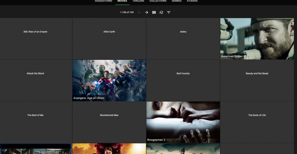

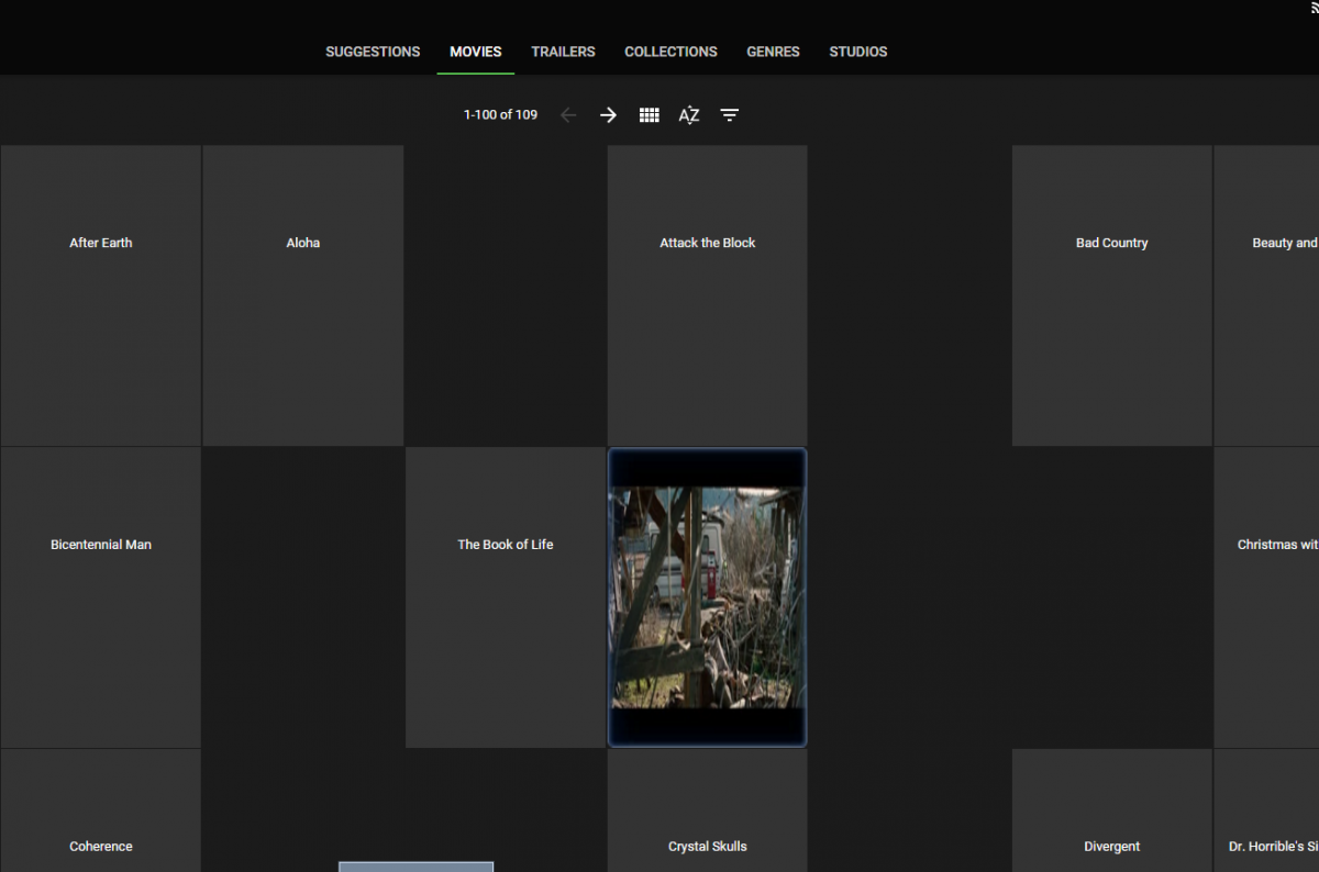

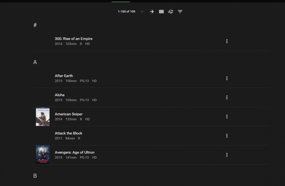

tymanthius 18 Posted January 13, 2016 Author Posted January 13, 2016 Ok, I'm still fighting this issue and need some help. I recently moved the library & refreshinfo db's out to a diff dir to see if that would help as it was listed as possible (but unsupported) fix. It changed things, but it didn't fix it. Still not getting posters consistently. In 'poster' view I don't have a poster for American Sniper. But in 'List' View there is one, is a good example of inconsistency. But MOST of my movies don't have posters/banners/thumbs/etc. This is annoying the ever-living fsck out of me. I'll be happy to post logs but if I know what to look for, I may can find it myself. See attached for how my views look. List: Posters: Thumbs:
