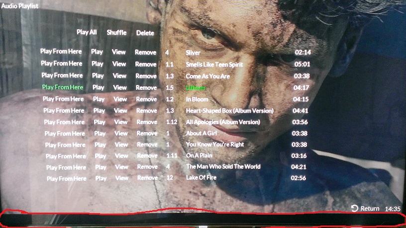

FrostByte 5453 Posted January 3, 2016 Posted January 3, 2016 I created a separate topic because of further testing and because previous topic was locked per request Issue description: Screen / backdrop shifts up the first two times you click the down arrow within an audio playlist Steps to reproduce: Click playlist from menu Select an audio playlist Press the down arrow on remote like you want to select a particular song, whole screen jumps up a line Press down again and screen jumps again My TV/HTS/BDPlayer: UN55F8000 with 2014 evokit My firmware version: 1209.1 Other TVs etc. the issue has been reproduced on: This is NOT a problem with my HTS-F6500W so it may be an issue with H series SmartHub only My Emby server version: 3.0.5800.3 My current Emby Samsung client version: 2.0.4a Other Emby Samsung versions the issue can be reproduced in: not sure Developer comments: 3
cmcg 876 Posted January 3, 2016 Posted January 3, 2016 I just need to prevent the app from stretching beyond the screen size when displaying long lists. Some devices are more sensitive to the issue than others. I should be able to sort it. 1
sh0rty 727 Posted January 3, 2016 Posted January 3, 2016 I just need to prevent the app from stretching beyond the screen size when displaying long lists. Some devices are more sensitive to the issue than others. I should be able to sort it.Same for movie files with 3 rows of mediainfo icons, e.g. some 3D files. The described effect happens there also when scrolling down through the menu points. Gesendet von meinem HTC One M8 mit Tapatalk
cmcg 876 Posted January 3, 2016 Posted January 3, 2016 (edited) Thanks Shorty, I didn't even realise that the media icons sometimes extend to three rows. They were not intended to. Edited January 3, 2016 by cmcg 1
SamES 1084 Posted January 4, 2016 Posted January 4, 2016 I just need to prevent the app from stretching beyond the screen size when displaying long lists. Some devices are more sensitive to the issue than others. I should be able to sort it. While playing a movie, if you get the Tools menu up (with Chapters, subtitles, etc), then press down arrow, the whole screen overlay moves up. Press up and the overlay will move down one row. Not sure if maybe there is a vertical sizing issue in the 1080p release? If you get the Info overlay up while playing a movie, the press down/up, the same thing happens. I haven't noticed this in the non-1080p version, but that's not to say it doesn't happen as I have not tried it specifically for this problem. 1

Solution FrostByte 5453 Posted January 6, 2016 Author Solution Posted January 6, 2016 Confirmed fixed in 2.0.5a 2
cmcg 876 Posted January 6, 2016 Posted January 6, 2016 (edited) Hopefully this issue won't show up too much anymore. But just to let your know that since I switched to 1080p development, it is more difficult for me to replicate this particular issue now. Thanks for testing and providing clear bug reports. It's a big help. Edited January 7, 2016 by cmcg 2
