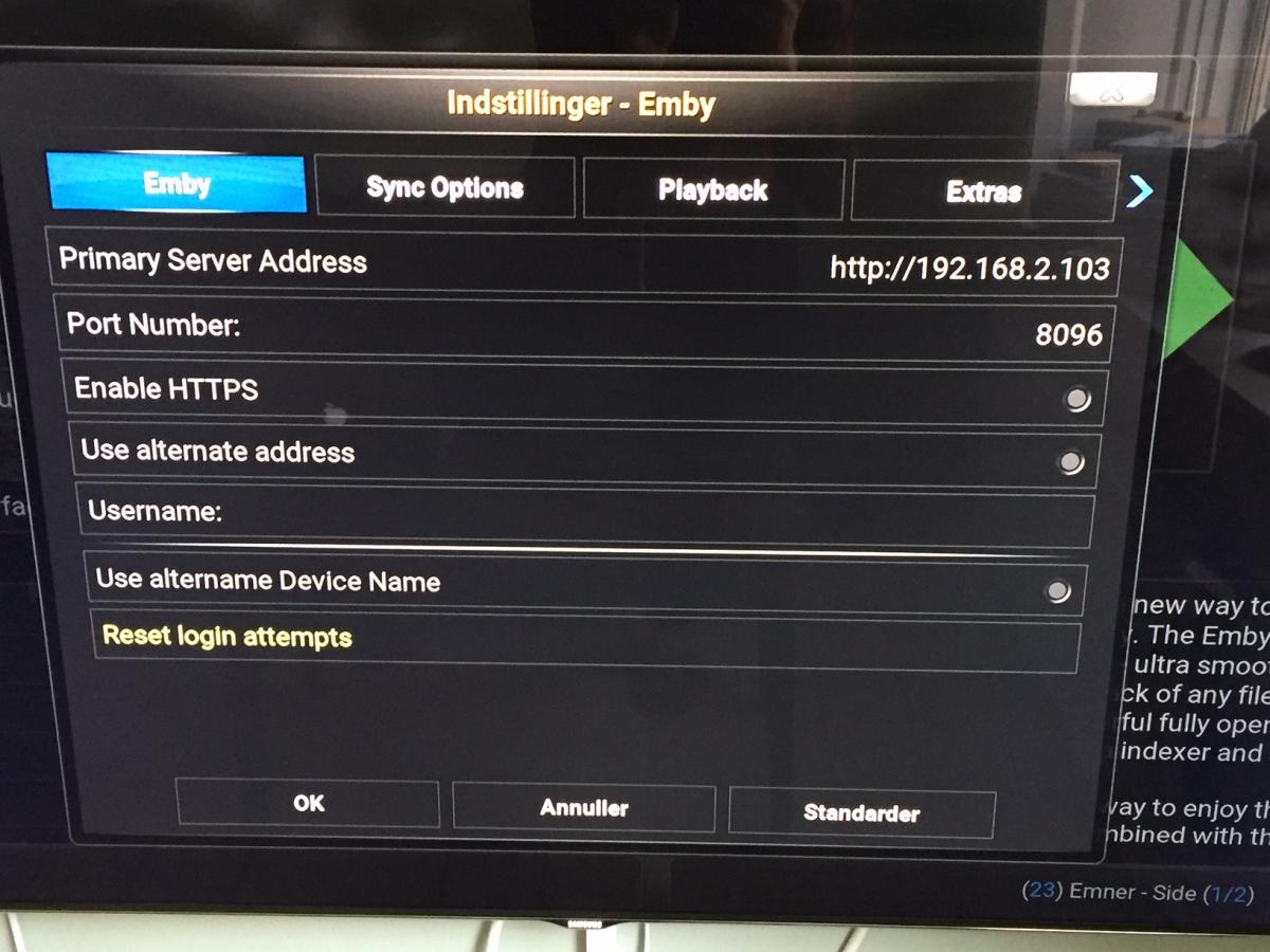

kanonen 0 Posted December 31, 2015 Posted December 31, 2015 Hello, I'm a first time Emby user, long time XBMC/Kodi user having trouble setting up Emby. I've followed the tutorial pinned here on forum, but still having the "Emby server is unreachable" error What I've tried a few times: Clean install of Kodi (on CuBox i4) Portforward 8096 to 192.168.2.103 (CuBox IP) Install Emby 1.0.4 depository Install Emby system My system doesnt autodetect the local IP so i manually input 192.168.2.103 and nothing else - tried reboot - still doesnt connect. I can easily reach 192.168.2.103 via Kodi Webclient or from my laptop My setup: Emby 1.1.69 Kodi 15.2 Git:02e7013 Log file and screenshot of settings included 01_KODI.log
Angelblue05 4132 Posted December 31, 2015 Posted December 31, 2015 Remove the http bit. Sent from my iPhone using Tapatalk 1
kanonen 0 Posted December 31, 2015 Author Posted December 31, 2015 Remove the http bit. Sent from my iPhone using Tapatalk Thanks for the reply - but I just added http as a test, the original input was IP only - just tried again with just 192.168.2.103 - same error
Angelblue05 4132 Posted January 1, 2016 Posted January 1, 2016 Remove the http part as it's added by the add-on. Make sure your port 8096 is open in your server's firewall. 1

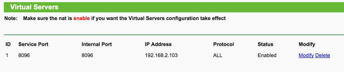

kanonen 0 Posted January 3, 2016 Author Posted January 3, 2016 I have removed http port and port 8096 is forwarded to 192.168.2.103 (see the 2 screenshots) I have attached a new log for you. Any possible solutions?? 01_KODI.log

xnappo 1611 Posted January 3, 2016 Posted January 3, 2016 This is on your local network? It is definitely configured wrong. If you are on your local network, you don't need anything forwarded. If your server is on a different network than the CuBox, you would forward 8096 to the server. The way you have it now, it is trying to go to the CuBox instead of the server! xnappo
