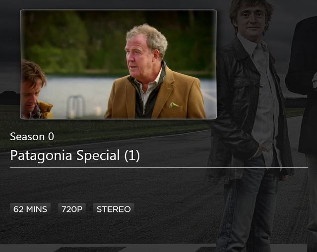

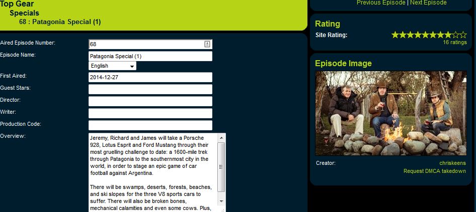

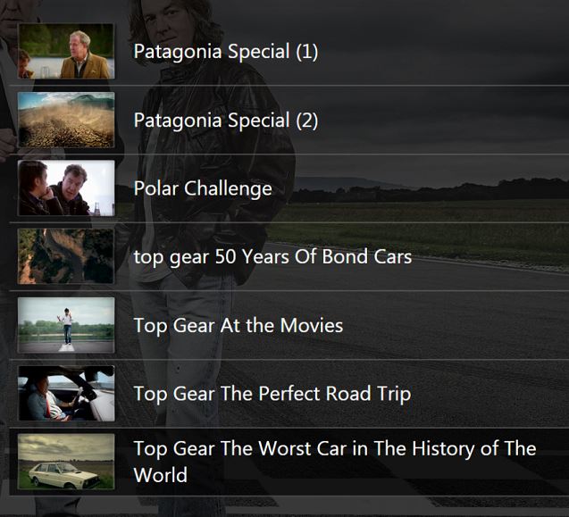

mystic.bertie 23 Posted January 3, 2016 Author Posted January 3, 2016 (edited) well i have some good news, i deleted the images and metadata in the same way i did before, this time when i did the refresh it collected the correct episode imaged for all 22 seasons. It still wont collect metadata for the specials folder, as you can see it is only taking snapshots from the video and not getting images or metadata from TVDB. The 7 specials i have are named the exact same as the titles on TVDB. path to my folder with the specials E:\Media Collection\Tv Series\top gear\Specials images and log file attached server-63587375999.txt Edited January 3, 2016 by mystic.bertie
Solution Luke 42185 Posted January 3, 2016 Solution Posted January 3, 2016 specials still have the same naming convention rules as regular episodes so they still need the 0x-68 or S00E68. It's probably a good idea to support just the episode name but it doesn't as of now, never has. 1

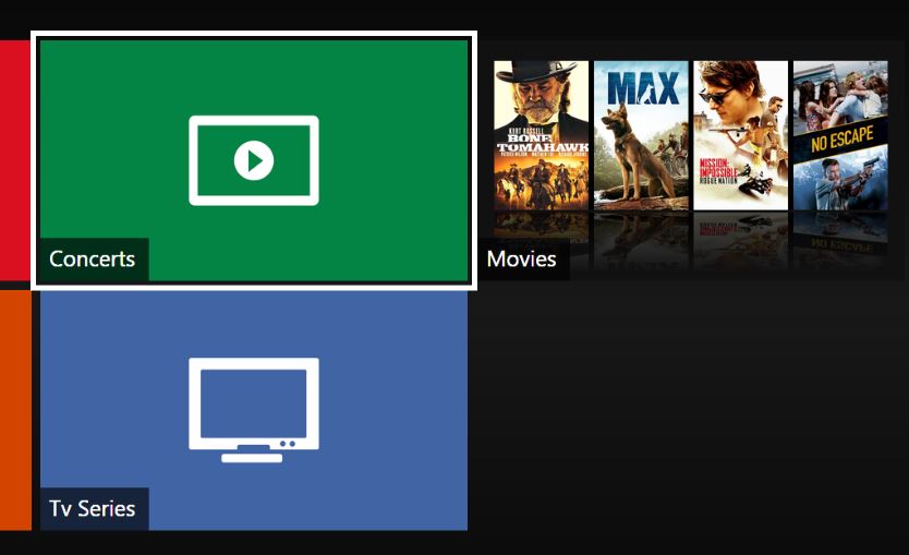

mystic.bertie 23 Posted January 4, 2016 Author Posted January 4, 2016 specials still have the same naming convention rules as regular episodes so they still need the 0x-68 or S00E68. It's probably a good idea to support just the episode name but it doesn't as of now, never has. Many thanks, this has sorted my problem, after renaming the video files the correct metadata was retrieved. Great advice (thumbs up) do you happen to know why my movie folder is displaying differently from the other folders? I searched through all the setting but i could not find anything.
