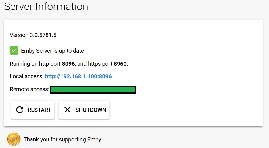

smc007i 1 Posted December 13, 2015 Posted December 13, 2015 Hi, I saw a few other posts with people asking about the Local IP value, but none seemed to have my problem. I know you can use localhost:8096 to find your server, that's not my question. My Local IP address shown on the server system page is not the IP of the machine the server is actually located on, why would this happen? Is it self detecting? I cannot seem to find a setting page to enter a local IP. I've attached the screen shot below, the Windows machine that my server is located on is .10, not .100 (it's always on .10 because I fix the address in my router). How is this being address determined? If I click on the address it (obviously) takes me to the wrong place that doesn't work - there is another device with .100 on my network. If I click the remote access link there is no issue and the server can be reached - I use no-ip.com to run a hostname. The only reason I started looking at this was because my Roku channel couldn't connect to my server on my local network and I had to manually enter the IP address of my machine and then there was no further issue and the server could be found. I wondered if this incorrect local IP might have contributed to the Roku's issue. Regardless, how can I get the local IP to show correctly? I cannot find anywhere to set this going through the menus, have I missed it?

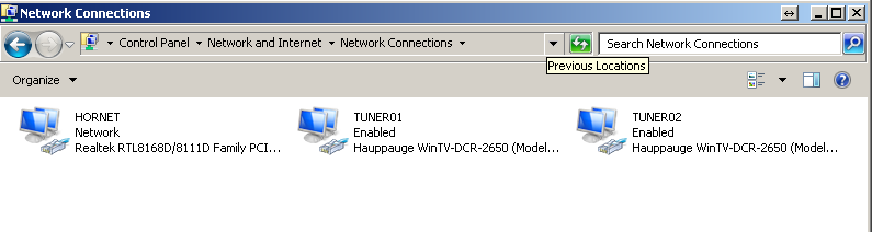

theniteow1 25 Posted December 29, 2015 Posted December 29, 2015 (edited) http://192.168.235.186:8096http://192.168.76.234:8096 So these IP Addresses are the assigned IP Addresses to my Hauppauge DCR-2650 Tuners, so yes in a way they would respond to a ping, and they are valid. However, they are not the actual IP address of the server, but, they are viewable as actual "network" devices, as seen below: So I don't think a ping would be able to determine if these are valid network devices or not. Would a tracert maybe better? Perhaps to see if it's able to talk to the Internet... Dunno, just throwing out ideas... Edited December 29, 2015 by theniteow1

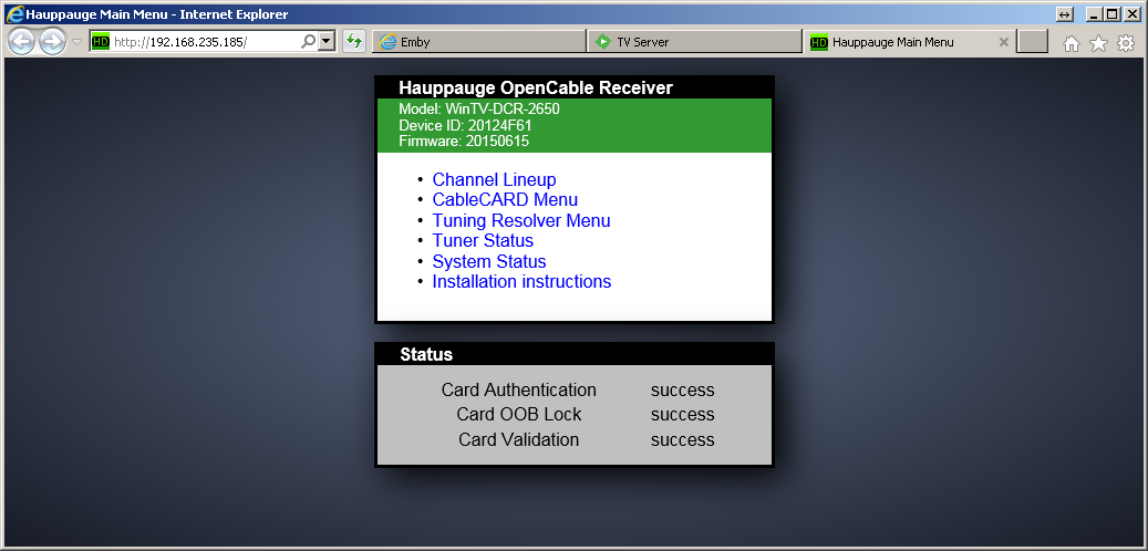

theniteow1 25 Posted December 29, 2015 Posted December 29, 2015 Sorry, I should have worded it differently. It's not a ping in the true sense of what you're thinking of. It's a real http request to an actual emby server api url. The fact that it succeeds means that emby server is capable of receiving traffic at that url. These tuners have a web interface you can go to see the status, so an HTTP is still going to come back with something. For example:
Luke 42198 Posted December 29, 2015 Posted December 29, 2015 yea i understand, but what's happening is those devices are not requesting exclusive access for all ports but rather just the ports they need (80). Emby is doing the same for port 8096 and listening for traffic on all available network interfaces. So while it might look odd to see that as the local address it should work just fine.
