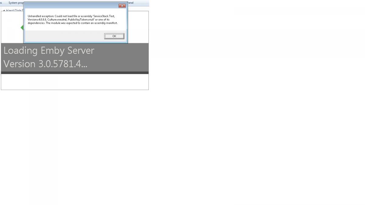

kcrandall758 1 Posted December 11, 2015 Posted December 11, 2015 I get the following error when attempting to start emby after a reboot: Unhandled exception: Could not load file or assembly 'ServiceStack.Text, Version 4.0.0.0, Culture=neutral, PublicKeyToken=null' or one of its dependencies. The module was expected to contain an assembly manifest. upon hitting OK, the error goes and emby does not start.
Luke 42186 Posted December 11, 2015 Posted December 11, 2015 That's very strange. I've never seen that before. If you have an anti-virus installed make sure it didn't delete any server files. There is a new update so I would just install the latest version on top of your existing install.
kcrandall758 1 Posted December 12, 2015 Author Posted December 12, 2015 that worked, although I had to do it twice. the first time it gave an error after running; after the second time, it ran successful - thanks! 1

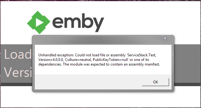

Morphy 3 Posted April 4, 2016 Posted April 4, 2016 I updated last night and have the same error today: 2016-04-04 16:38:54.3905 Error Main: UnhandledException *** Error Report *** Version: 3.0.5912.0 Command line: C:\Users\AM1\AppData\Roaming\Emby-Server\system\MediaBrowser.ServerApplication.exe -service Operating system: Microsoft Windows NT 6.1.7601 Service Pack 1 Processor count: 4 64-Bit OS: True 64-Bit Process: True Program data path: C:\Users\AM1\AppData\Roaming\Emby-Server Application Path: C:\Users\AM1\AppData\Roaming\Emby-Server\system\MediaBrowser.ServerApplication.exe Could not load file or assembly 'ServiceStack.Text, Version=4.0.0.0, Culture=neutral, PublicKeyToken=null' or one of its dependencies. The module was expected to contain an assembly manifest. System.BadImageFormatException at MediaBrowser.Common.Implementations.BaseApplicationHost`1.<Init>d__4.MoveNext() at System.Runtime.CompilerServices.AsyncMethodBuilderCore.Start[TStateMachine](TStateMachine& stateMachine) at MediaBrowser.Common.Implementations.BaseApplicationHost`1.Init(IProgress`1 progress) at MediaBrowser.ServerApplication.MainStartup.RunApplication(ServerApplicationPaths appPaths, ILogManager logManager, Boolean runService, StartupOptions options) at MediaBrowser.ServerApplication.MainStartup.Main() Will try updating again.
Morphy 3 Posted April 4, 2016 Posted April 4, 2016 Ok so I've redownloaded the installer and disabled avast as suggested in another thread and it seems it had to download an update to .net framework. After rebooting I got an I/O error when backing up the emby dir. Now Emby has not launched as a service for some reason. Not sure what's going on but it seems to be working ok now. I'm going to look at the auto updater script and also maybe even a fresh install when I've got the time as I don't like the sound of that I/O error. It's a fairly new cloned samsung EVO SSD so it shouldnt have any issues...
Luke 42186 Posted April 4, 2016 Posted April 4, 2016 In my opinion I think you should run hardware diagnostics in addition to chkdsk. The only other time I've seen the error in post #4 was a main drive failure. I was already beginning to think that before you even mentioned the I/O error.
